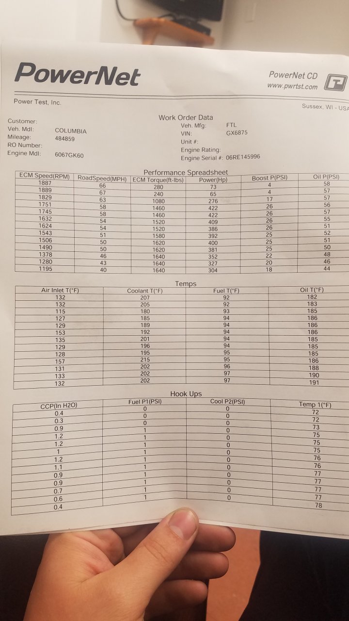

  11. martin2722
    martin2722 Light Load Member
    68
    34
    Feb 4, 2017
    They did the dyno and this is what they got ( guy said he did a second test and it did 445hp)
    Dave_in_AZ Thanks this.
