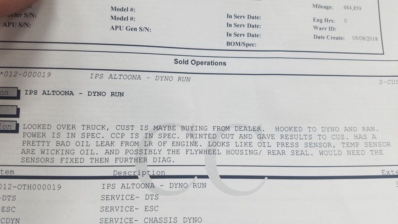

    If the rear case is leaking (relatively common on 60 series) that's an expensive repair.

    The tech that did the inspection said 3 to 4k, is that even close?

    Id guess its in the ballpark. But also keep in mind a couple things, they gotta drop the transmission. So perfect time for clutch and rear engine mounts. If you got a transmutation out always always always put a new clutch and rear engine mounts in. 99% of the labor is already done just dropping the transmission.

    The guy said dropping the tranny around 10hours plus seal/gasket and $2300 for a clutch

    Thats insane. A clutch is 500 to 700 bucks and at most one additional hour of labor. Or did he mean an additional 10 hours labor after the 2300 for the clutch job?

    He said 10 to pull the tranny down and put it back and 2300 for the cluch( but thats Interstate powersystems, $135/hour

    That is almost 3 times what a clutch should cost.
