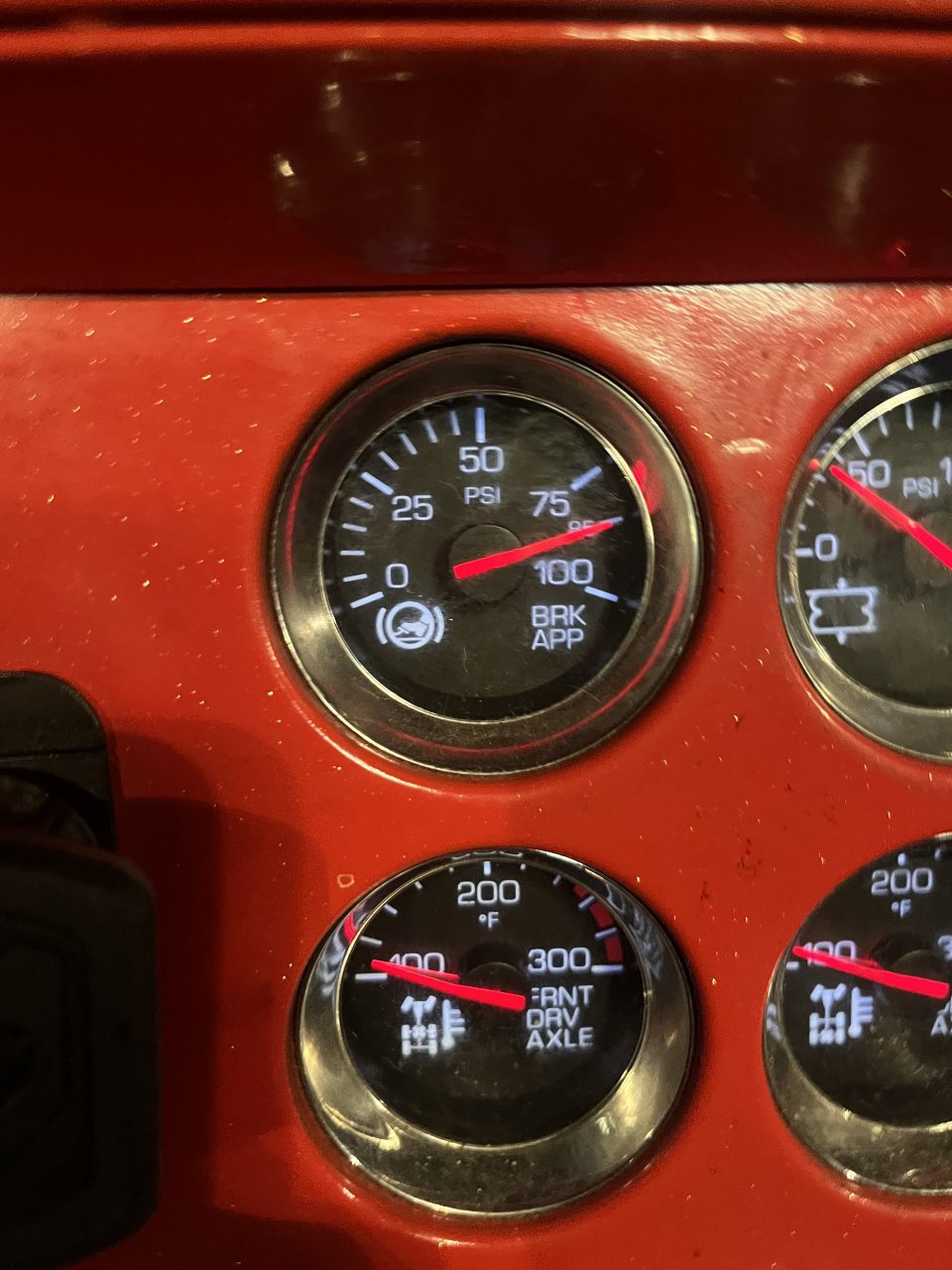

    Yes I sprayed some wd-40 behind the brake pedal. Worked the pedal up and down to no avail…

    If the pedal is sticking WD 40 won’t work like PB Blaster. The PB Cleans the dirt and grime out like WD 40 won’t do. If your pedal is not sticking this won’t help, but there really is a huge difference in PB Blaster and WD40.

    If there is air, see if it's coming out of the blue line, or out of the trailer gladhand.

    Yes. I shut truck off and pulled blue line, pressed pedal and heard air
    No air feeding back from trailer gladhand

    Ok. Has that application gauge shown pressure since this started, or has it always?
    I'm going to figure you'd know if your brakes were dragging, especially 80 psi
    Oxbow and nikmirbre Thank this.

    No this gauge hasn’t always shown pressure…. Just since this started. I parked Thursday and everything was fine. And id know if my brakes were dragging
