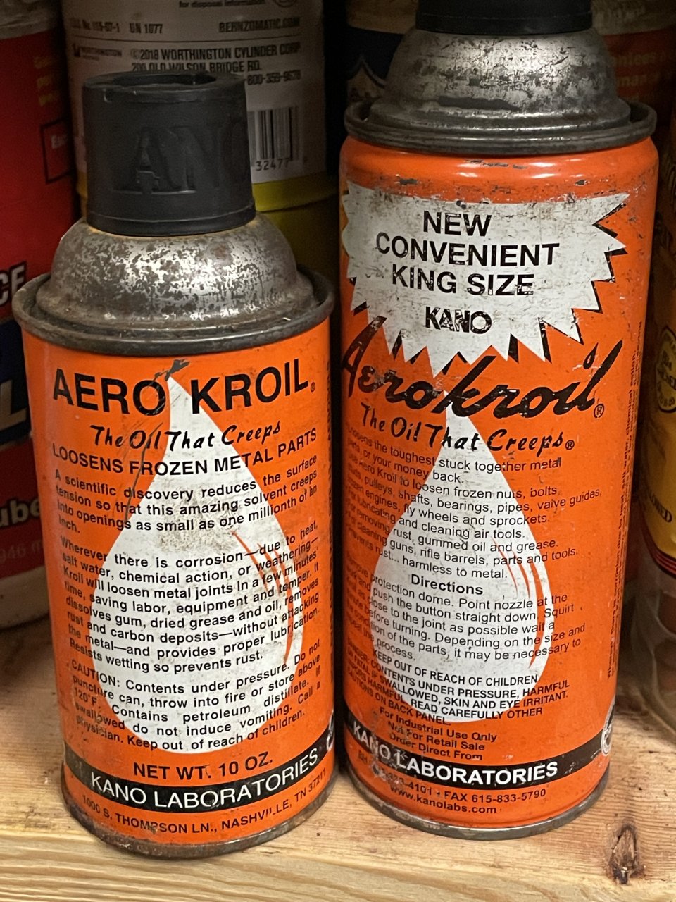

    This is good stuff too, much better than WD40….

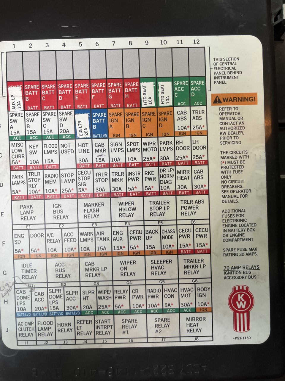

    Sorry for the rabbit hole I sent you down. Everything I said was based on the assumption that the gauge was seeing actual pressure.
    Now I would think yes, you likely just have a brake pressure sensor? .
    Never seen or heard of one, dealer should be able to tell.
    Or, possible still, since it appears electronic driven, a relay backfeeding?
    If you have a brake light relay, Swap it for another just to rule it out quickly.
    That truck likely has a PDM on the left side of the firewall. I've seen 2 of those that had gotten extremely hot and melted terminals internally.

    "Normally", the majority of pressure sensors and switches are in the air manifold, not directly attached to the item it is related to.
    But, I see you have two switches in that air line in the pic, so I'm not sure. I blamed bubba, but after a closer look, the yellow air line and first switch on it look factory.

    Pull that traiiler stop relay just for S&G and see if it affects the gauge.
    nikmirbre Thanks this.

    No affect on it......
