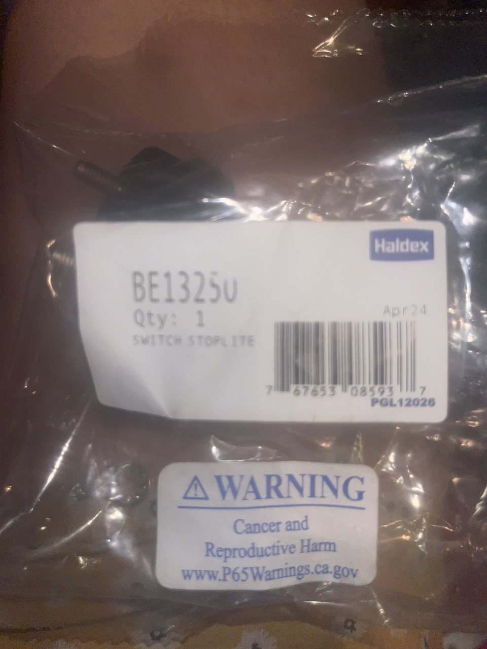

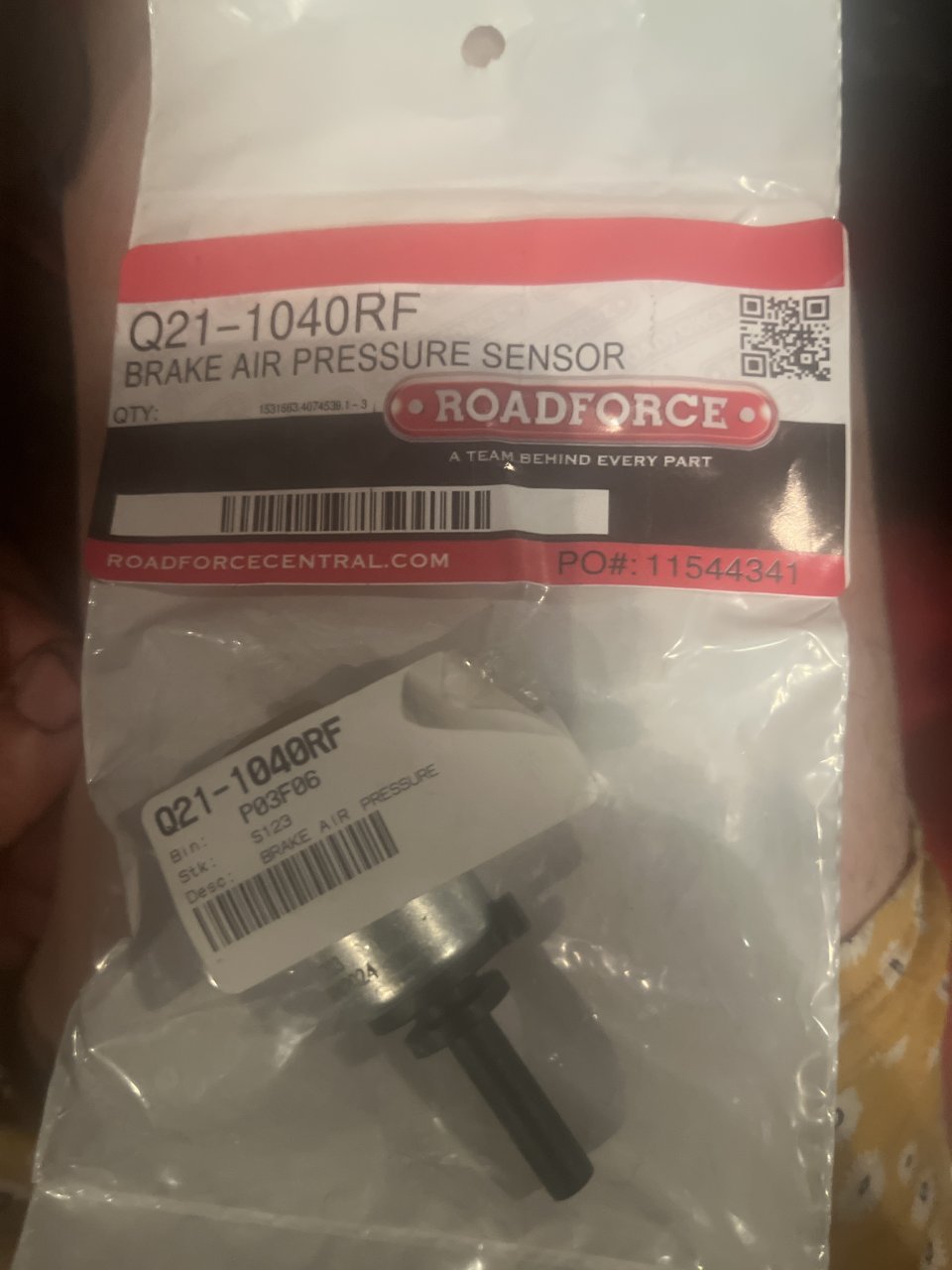

    Ok I went to KW...I purchased a brake air pressure sensor and a stoplight switch....
    I unplug the brake air pressure sensor and everything works fine!!!!! When I plug it back in, brake lights come on and stay on.....
    Edit to add...and the gauge that was showing 80 psi is now at zero when unplugged.
    Im gonna assume that this sensor is the problem and just change it out.
