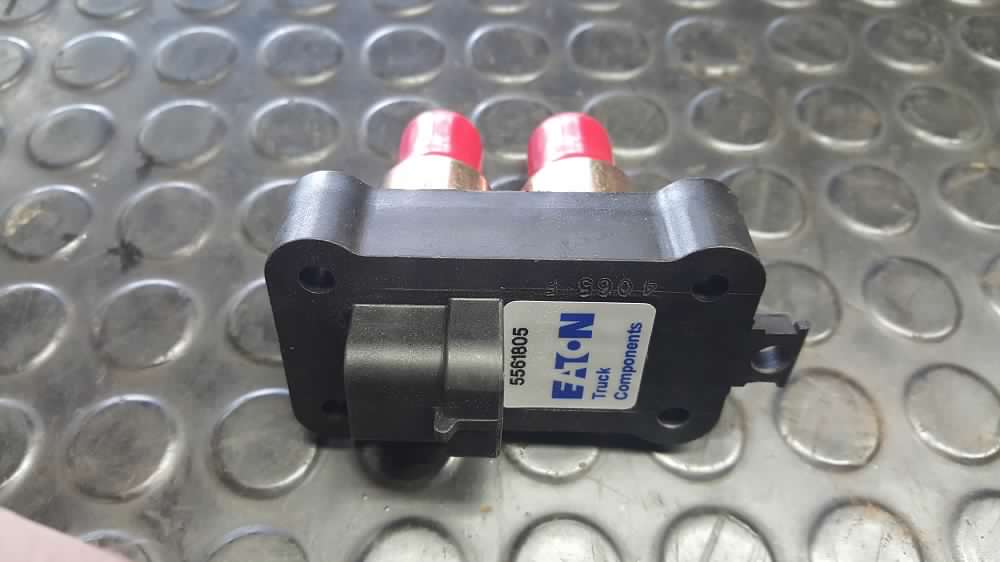

    My O-ring kit has arrived. I’ll try fixing,one this weekend. Eaton part # K-2908
    On the UltraShift transmission is an electrical solenoid that operates the high-low range . Inside is two plungers with four o-rings. Looks easy to change, if it doesn’t work in my case then I’ll try the dealer.

    Changed the o-rings, only a 15 minute job .but that wasn't it So it must be the range piston o-rings.

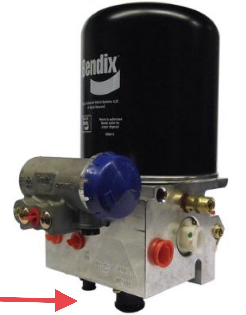

    Have you checked your air dryer purge valve. It’s known for leaking irregularly? Put your hand over it while your truck is idling, and also while the engine is off. Do this throughout the day as it’s not a constant leak.
    When you are checking for air leaks, it’s important that you are supplying air to your truck. Chock your truck or set the brakes on your trailer. If you want to check your trailer, set the brakes on your truck, and supply air to the trailer. You also want to lightly move the air lines around while spraying them with soap and water. It could be you have an air line that is coming off when the air is hitting it at highway speeds. Make sure your air tanks are completely full of air, typically around 130 PSI.
