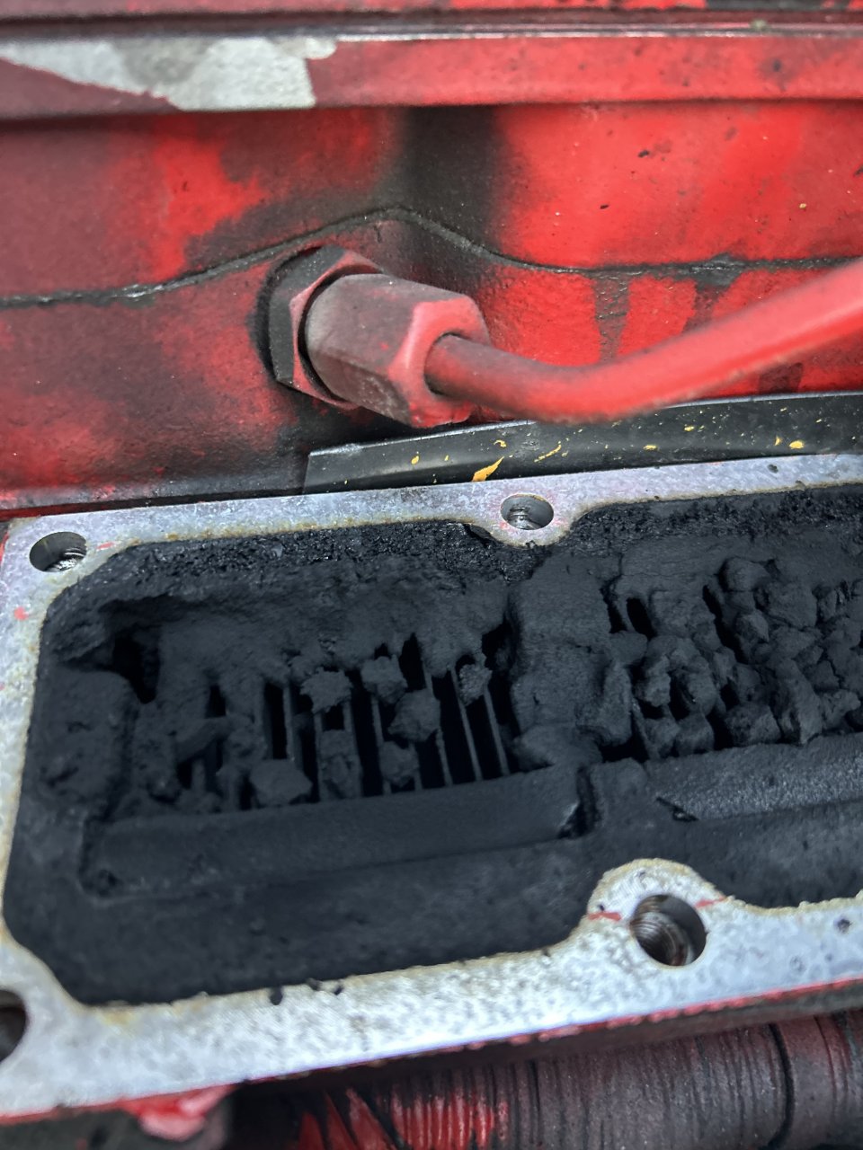

    I have a check engine code spn-3058 "warm engine" on the dash of my 2019 international 4300 box truck with a Cummins engine and a Eton prosicion trans. Can anyone help with your ideas on what the problem could be? From my research it could be the EGR clogged or the DPF needs cleaning last differential pressure sensor.

    Need to know what the last two digits of the code are. It could be 3058 fmi 16,fmi10,fmi9 etc.
    If you don’t know when the last time the egr valve was cleaned, it would be a good place to start.

    The egr system is clogged. I think the egr cooler could be leaking from the inside.

    It’s fairly easy to pull the crossover tube and look in the front of the egr cooler.
    Yours may look like the one I’m working on now.
    that’s the intake

    The intake probably looks like that. Im going to take it apart and clean the whole egr system. I think that should do the trick

    I had warranty for the problem it was the EGR cooler leaking from the inside creating carve and clogging up the EGR valve as well. Problem solved no check engine light. Thank you!
