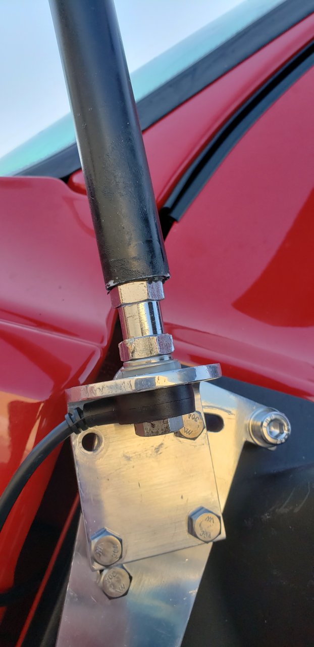

    So I have put the flat washer and the nylon insulating washer in place. Still have all the same indicators as last night's post; antenna warning, no static noise, failures in self-testing, etc.

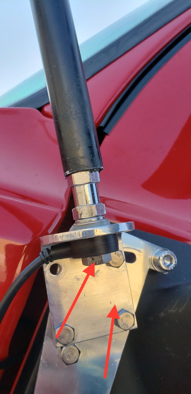

    IF you do then do the following -
    Set the VOM to ohms, first touch them to see if it working and adjust it (if it is analog meter) to ZERO it out.
    THEN disconnect the coax at the radio (very important)
    THEN touch the bolt and the bracket where the red arrows are on the following image ... Read the rest under the image ...
    IF you get no reading (meaning infinity) then it isn't the mount, the stud or anything else.
    Could be a defective antenna or something else.
    IF YOU DO GET a reading (meaning ZERO), take the coax off completely and check that at the connector end.
    IF you get no reading (meaning infinity) then the coax is ruled out for now. reinstall the mount without the antenna and do the test over. Make sure there is enough of an opening that the upper washer seats in to the hole and is not compressed.

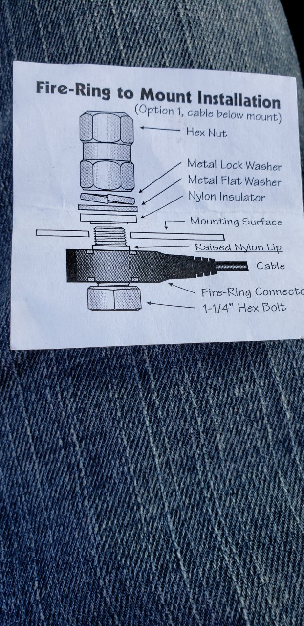

    Ok, you do have the fire ring coax installed correctly? By your picture it looks like there’s a raised nylon lip on the coax connector that faces up towards the mount.
    Best thing to do is use an ohm meter and check everything out like Ridgeline said.

    And yes, the raised nylon lip is facing upward. However, I have a suspicion it's damaged (squished down and allowing contact between the ring and the mount) and that is where my problem is.
    If I'm right, do you think an o-ring might suffice as an alternative to getting another coax?

    So my father-in-law and I checked continuity at the mount/bolt and at the radio side. The bolt was grounding to the mount, and we are pretty sure it was because of the damaged/worn down nylon shoulder of the ring coax. I probably over-tightened the bolt in a previous attempt and between that and the sheer weight and wind resistance felt by the antenna at 60+ mph, it caused the nylon shoulder to crush and mushroom. We thought maybe we could get it (the bolt) in there "just so" and lock it down. It was not to be. The second any amount of force was applied on the antenna, it started to short out. I think the bolt is coming into contact with the mount.
    Oddly, no resistance supporting this theory could be found anywhere. When the probes of the test meter were applied, the bolt and mount showed infinite, the ring and male end of the coax showed infinite (no break in the coax), and so did the collar and male end of the coax (no insulating/shielding failure). Even so, I still think that the weight of the antenna leaning at the angle that it is and the damaged nylon shoulder is intermittently allowing the bolt to ground to the mount.
    Sooooo, I'm hoping someone could provide suggestions for some coax to use and how to mount the antenna to the ProComm mount using that coax such that it doesn't short/ground to the mount. I'm thinking maybe it's not a good idea after all to use a ring mount with this big of an antenna?

    Put the antenna straight up. Why are you tilting it (rhetorical)
    Nylon is a tough material and you don't need a lot of torque to tighten a mount.
    Not trying to beat you up, but I think everyone makes this soooo complicated.
    So here is what I would do.
    Get coax with a pl-259 on the end, toss what you bought in your tool box.
    Use the mount you have.
    Go get nylon washers to replace what you destroyed.
    If you are worried about it coming loose, put a touch of loctite on the stud.
    Put the mount together with a connection on the bottom.
    Put the pl-259 connector with the coax on it.
    Test it as I described how to test it.
    If it is good, then transmit to see what the swr is,
    madmoneymike5 Thanks this.

    I'm still unclear as to how I would attach the antenna to the coax and the mount. With the ring connector, everything was held in place by a 3/8" x 1.25" M24 stainless steel bolt being screwed into the antenna. With the PL-259 coax there, you can't put a bolt into the antenna to hold it to the mount. Would you mind elaborating on the components and the order they go, starting from the antenna and working downward? Sorry...I'm a geek when it comes to computers, but outside of that, such as with other electronics and with mechanical things, I'm not super-duper intuitive. I need pictures and no assumptions that I understand something by those trying to explain something to me. Nothing is a given. LOL
