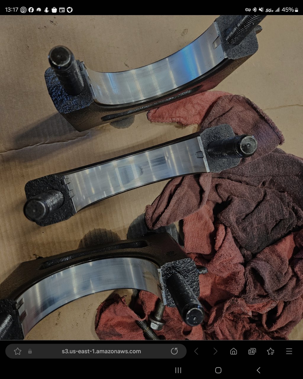

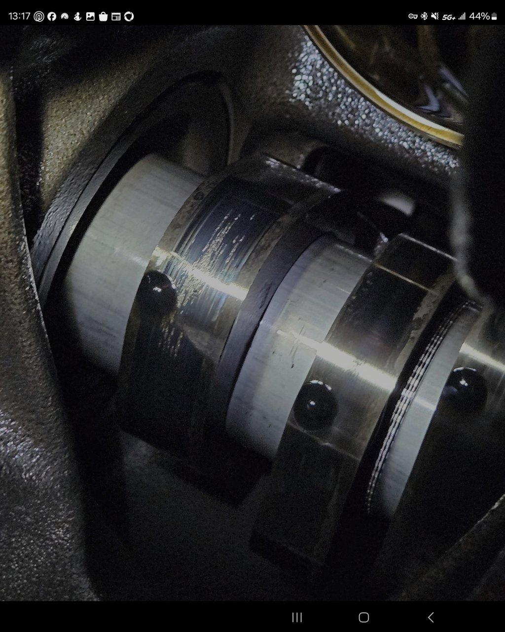

    I have my truck at kw and they just uploaded this and said they sent it to the engineers to get a repair plan put together. I have no idea what im looking at and the notes i can see are very vague.
    Does anyone know from these images how bad it is? To me it just looks scratched. Screenshot_20240415_131743_Samsung Internet.jpg Screenshot_20240415_131723_Samsung Internet.jpg Screenshot_20240415_131735_Samsung Internet.jpg Screenshot_20240415_131751_Samsung Internet.jpg Screenshot_20240415_131708_Samsung Internet.jpg

    Cam is toast.
    What sort of oil change interval are you running?

    Will likely get a new cam and lifters. Main bearings look ok.
    Repairs should be covered under 7yr 700k
    Engine will have to come out and it will likely be down for a 3-4 weeks.
