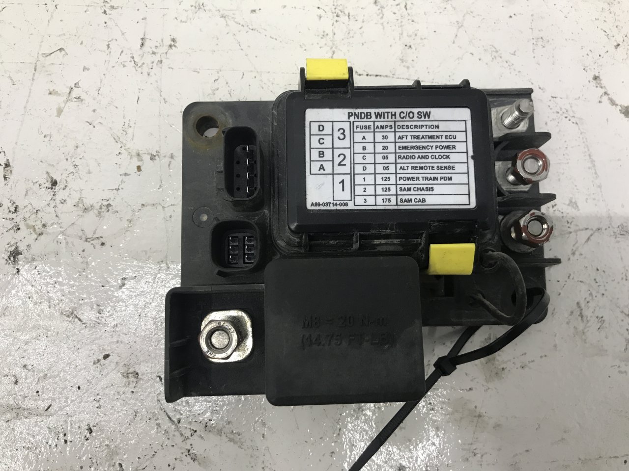

    Look in the owners manual. In a fuse block on the firewall near the steering column is a fuse labelled “Alt Remote Sense”.
    It’s only a 5 amp fuse. If it is blown, the alternator will not know what voltage is on the batteries and will over charge them. You getting a reading of 13.0 to 13.6 volts is exactly what mine was reading.
    Once I replaced that fuse the normal operation voltage is 14.2 volts.
    It’s in the PNDB module.

    Alright, so you were actually on the right trail! Took it to a AIM lease shop since they are the company I went through for my truck. They replaced all 4 brand new batteries AGAIN, put a brand new alternator, and correctly tested everything. So, after 9 brand new batteries, a new alternator, and almost a week of sitting, they found out is was the whole battery module that's got the 5 amp Remote Sense fuse. It was getting red hot somewhere he said, causing the voltage on the dash to be incorrect. Alt was overcharging batteries but the dash was showing way lower voltage.
    Glad I now have this figured out, and documented for other drivers.
    If anyone is ever experiencing boiling batteries, but the dash doesn't show overcharging, it could very well be the battery module. Mine was on the passenger side, under the hood on the fire wall. Red light was solid, indicating properly working, but it wasn't actually working.
