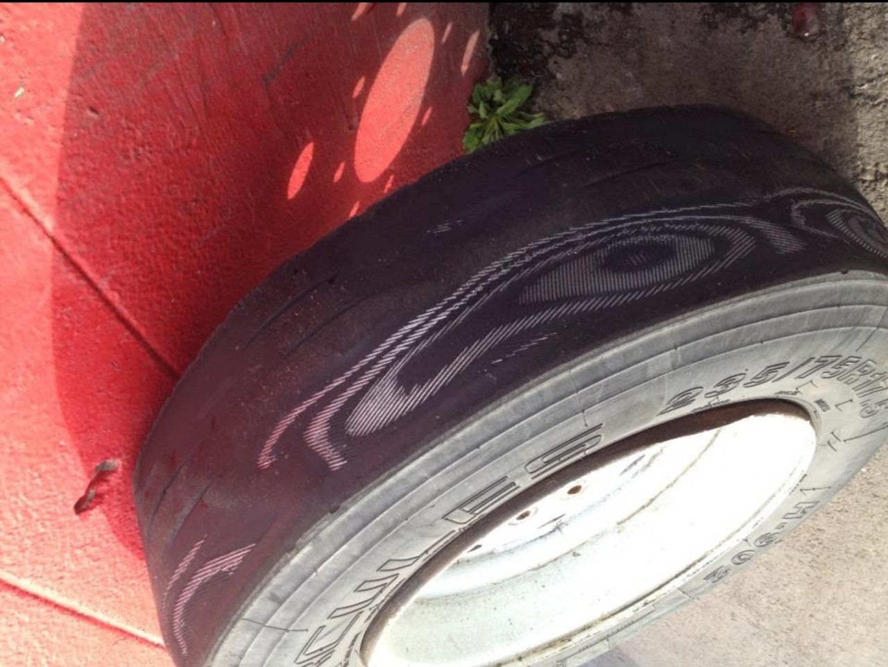

    I always carried a pair of Chinese spare tires with me when I ran 17.5s. one trip I spent 1,300 miles looking for a 17.5 in a shop that wasn't $600. Result posted below. I had decent luck with the Chinese spare tires they would typically last 80,000 miles. Under $200 each. Screenshot_20230914_065827_Photos.jpg
