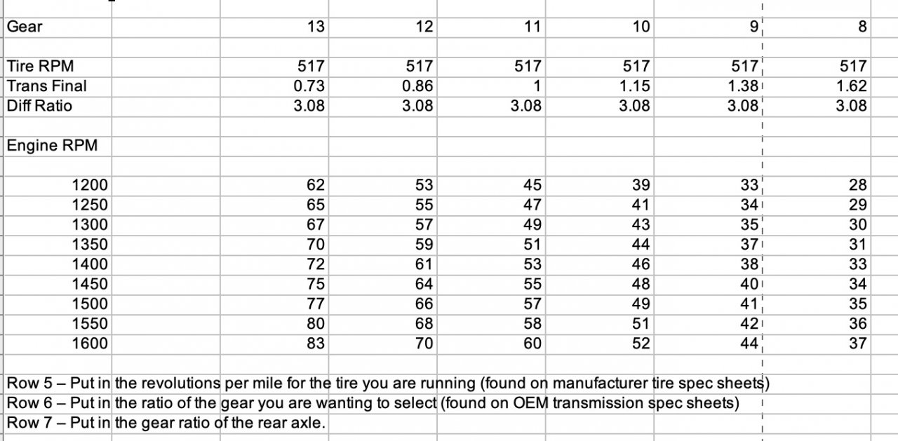

    Detroit 60 500 hp 1750 torque turning 1400 at 62 mph and 1500 at 66 mph. 18 speed running in 16th (direct drive) with 2.64 diffs on low pro 22.5 rubber. Average mpg over 926,000 miles has been roughly 7.5 mpg.
    3.08 would give me roughly the same engine RPM in 17th (1st OD) instead of 16th (direct) with 2.64. I would have no problem with that. Could offer a little better start off compared to 2.64.

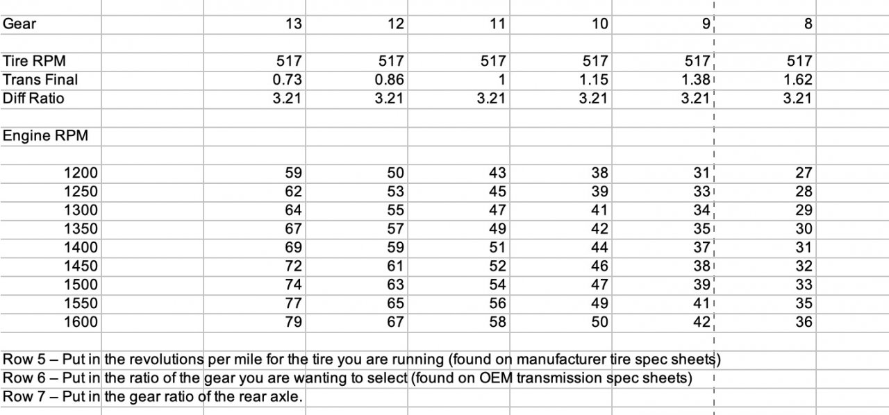

    I have a spreadsheet where one can plug in different differential ratios, different tire revolutions per mile, and the various transmission gear ratios and see what the actual road speed would be at various RPM's. Here is a screenshot from it with 3.08 diff ratio combined with a typical 13 speed trans....
    Given many would run the X15 at a little lower RPM than a Detroit 60 12.7, a 3.21 ratio might work a little better, depending one what you are doing with the truck.....
