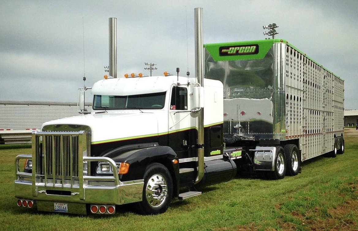

    I’ve always ran low 22’s and rarely drove faster than 70 when I was hauling cattle. This truck had 3.70’s and a series 60 Detroit with a 10 speed.

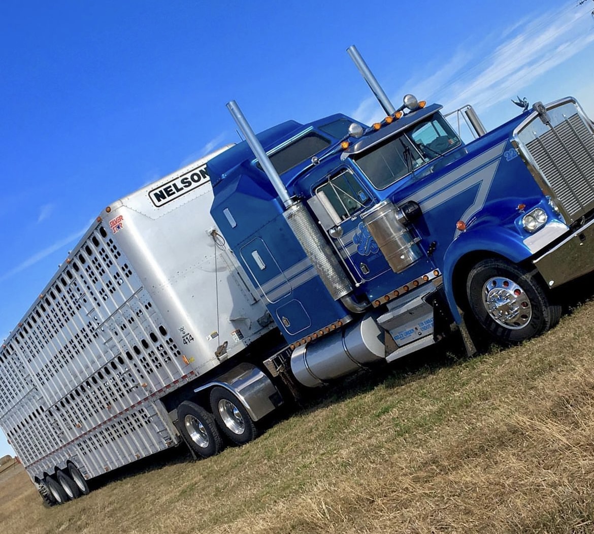

    This truck had 3.55’s with a 2LW Cat and a 13 speed.

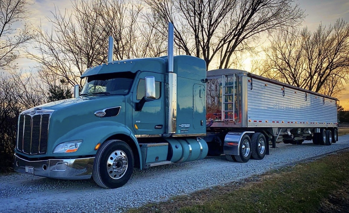

    This truck had 3.36’s and an MX13 Paccar with an 18 speed.
