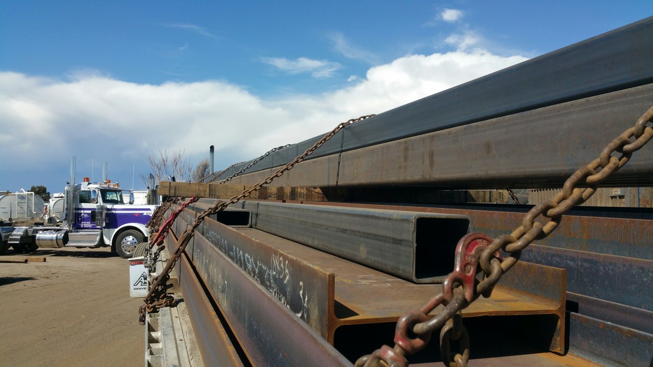

    well i've pulled a reasonable amount of steel (both beams and structural (fabbed) and honestly some loads are 5lbs of poo in a 2lb bucket. 3 of these, 2 of those, 9 of those all stuck together
    and while i might have enough for length and weight, ti's not actually enough to tie every piece down. (and many times had to put dunnage on top of the beam to give the chain/strap something to push down on.).
    look from the back
    this kind of "preloaded and chained down trailer" happens a lot. There's ZERO touching those two tubes.
    another good one (and this happens a lot, another preload) it looks from the side like it's great, but look up the trailer (we're at the back here), there's ZERO touching those two.
    but then sometimes the whole trailer is all the same size/length etc and it's just boom boom boom for length and weight.
    whitegmc83, Lepton1, D.Tibbitt and 4 others Thank this.
