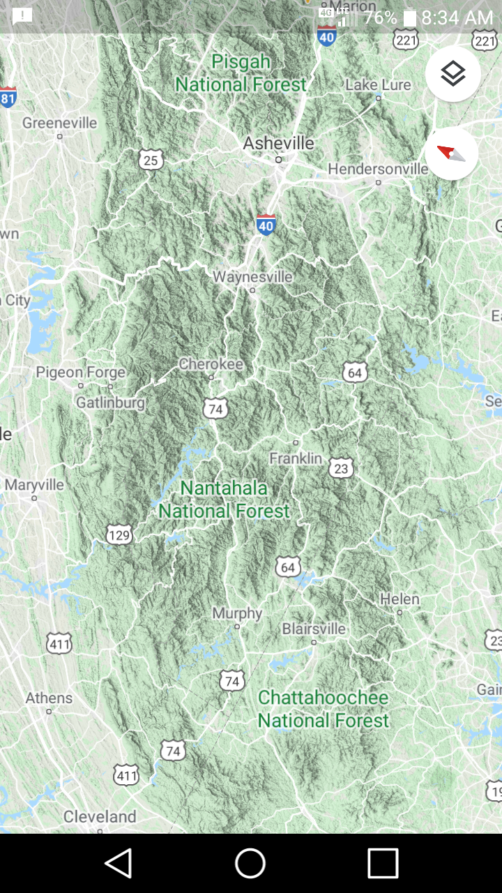

    Quarry roads and logging roads are the same thing, lotta quarries are leased from bowater timber grounds and theyre a lot better road than a small poor folks private quarry, i used to come out of one that had a ledgy creek crossing right in the middle of a turn. Just as your landing gear scraped your nose came up a rock ledge and turned into a gate, it sucked.
    I delivered all over pisgah, nantahala and chattahootchee and been up through most of PA and down to morgantown wv to pipeline drop site, ran across hunter mtn in the catskills. Theyre all just paved cart roads. If low hole is deep enough to take off on your steepest hill at max weight without throttle, youre rears are deep enough. Going lower takes from the top. Yes the deeper gear does take that percentage of load off the upstream driveline. One truck did throw shafts several times when it had a cowboy behind the wheel.
    Since you guys have lower speed limits the 3.90s wont hurt him but down here long legs are pretty important for navigating the watermellon 500. GPS wont tell you soon enough to know what lane, and at 70mph theres a river of cars packed up trying to come around both sides of you from behind as fast as they will go. Its scary how fast you gotta go down there to make yourself a hole for changing lanes, i hated it.

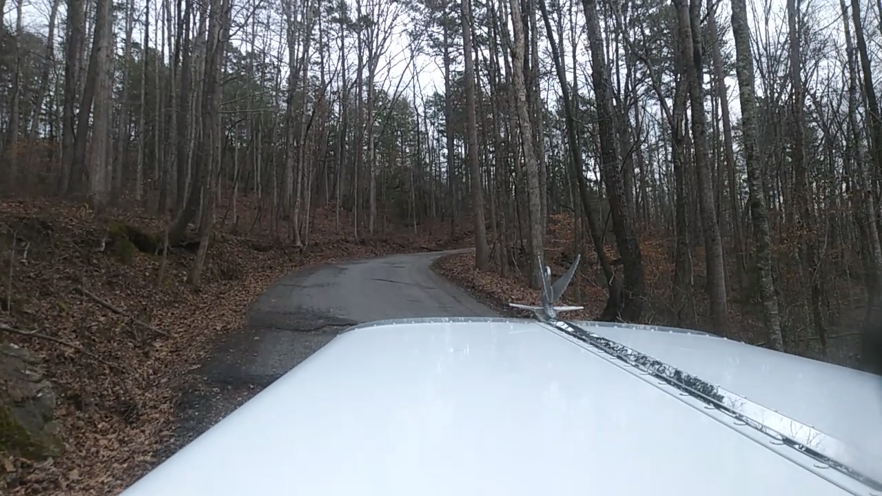

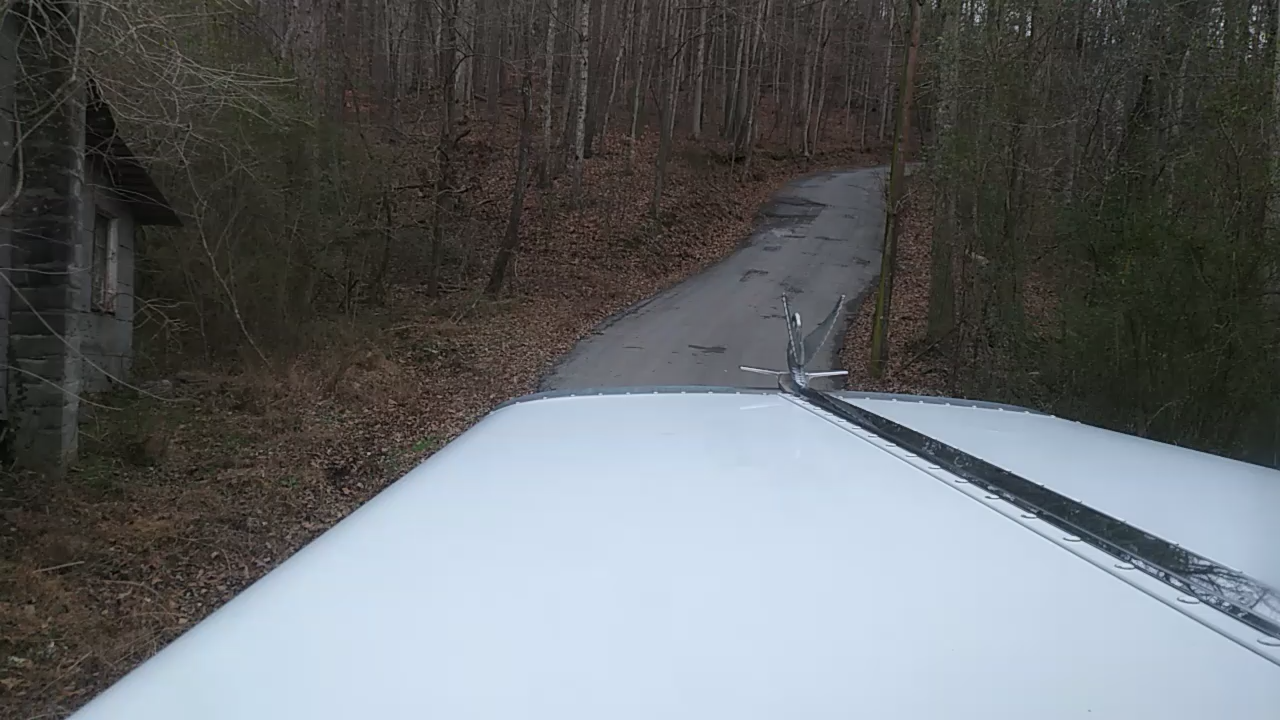

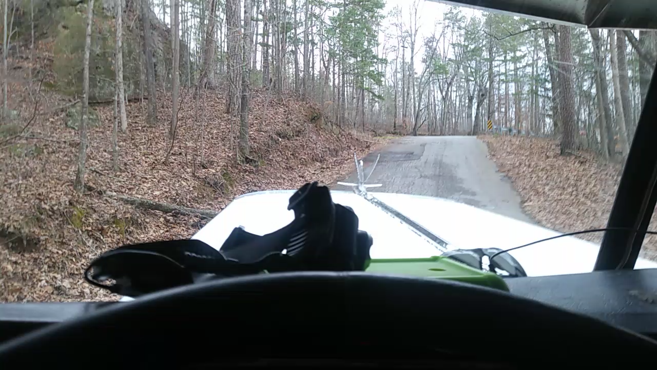

    Screenshot_2020-07-21-08-43-11.png Screenshot_2020-07-21-08-43-42.png Screenshot_2020-07-21-08-45-30.png
    I did this hill many times with 3.70s at 80k and that flat up there is the stop and takeoff for the main road. 3.90s will be great.
