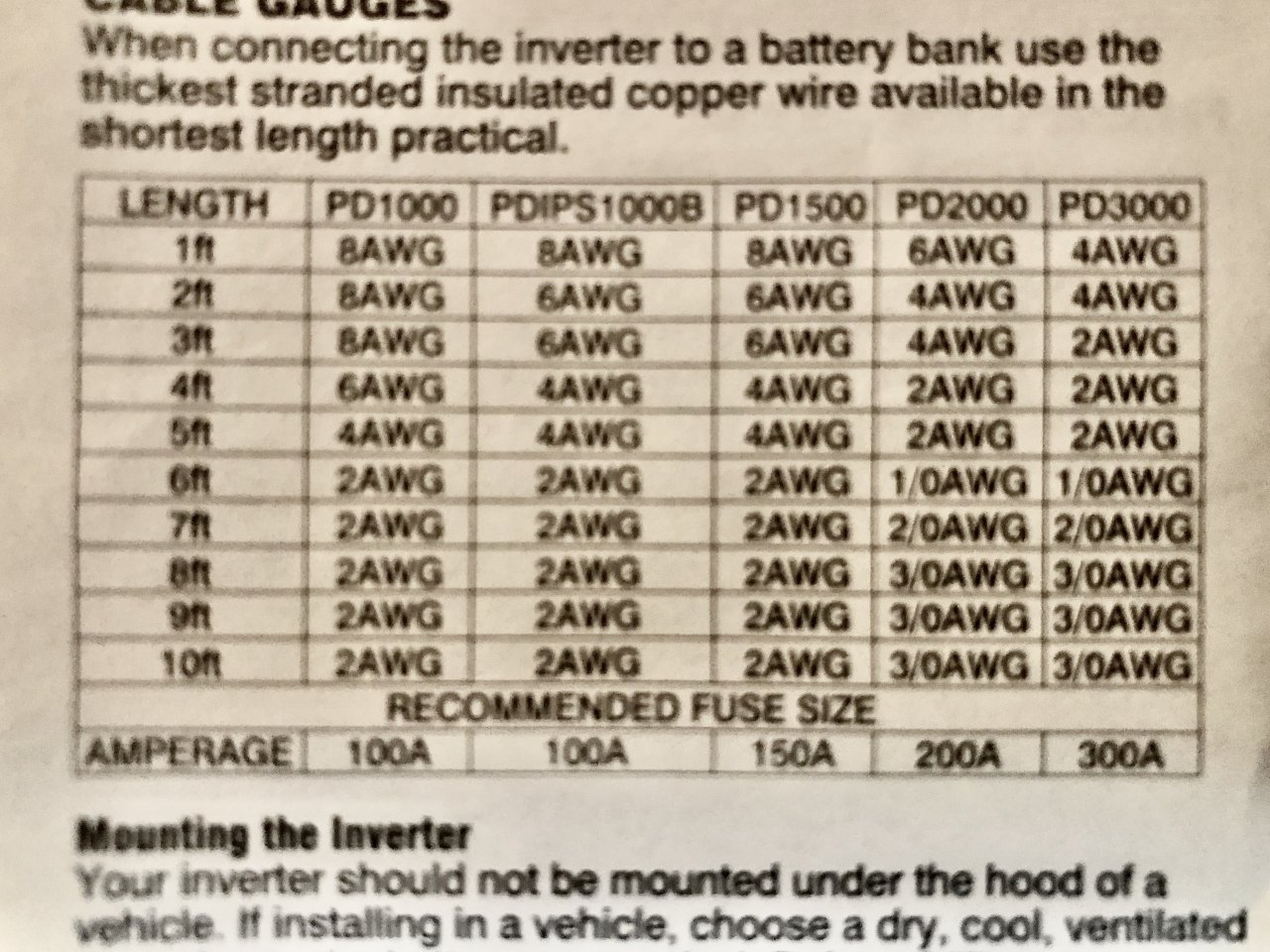

    For 3000 watts you need HEAVY cable I ran 4 runs of heavy welding cable and a 300a fuse. Watts law.
    EDIT; Found the calculator, it is here Inverter Calculator
    12v dc in, 120v ac out 3000watts
    10ft cables. =
    2 gauge cables, 300amp input draw. (Fuse)

    Do yourself a favor and buy a good brand sine wave inverter. Xantrex is good. I ran a 2000W in my old KW for 8 trouble free years. It's also the brand inverter that Thermo King packages with a Tripac APU. More recently I've installed two Giandel 2200W inverters the past year. The first one was in another truck I traded off, and the inverter is now about 4 years old trouble free. That brand (from Amazon) is unknown in the US, but seemed to be more popular with good reviews in Europe and Australia.
    Mine are on an 8 foot run of 2/0 wire with a 250A ANL (lug style) fuse someone posted earlier. Cooking appliances hit the batteries pretty hard. Especially things with an electric heating element like a coffee maker or hot plate. Be sure to check the watt rating on anything you plug in, bearing in mind most truck alternators are less than 150A max output, APU's usually 1/3 of that. In other words, enough load will easily out run your alternator and still discharge your batteries even with the engine idling or APU running if you have one.
    By the way, the good inverters also have a low voltage safety cut off, usually around 11.5V. They should shut down before they discharge the batteries too much to start the engine, or spike the amperage due to excessively low input voltage.

    3000w with 1/0 at 4ft and 300amp breaker is what I used. Make sure it’s real OFC and not CCA wire.
