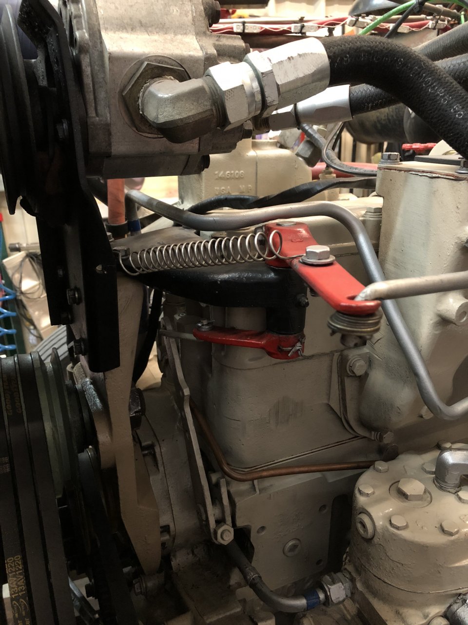

    F6F9FB68-CDD1-45E9-B58D-A686674AE7BA.jpeg On the NH250. Just a 3/8” rod bent to clear steer pump reservoir. Just simple bent end with hole for cotter pin. I added the stack of washers to shim out the wear and the return spring. This setup had a spring behind the knob mount on the dash but over time they weaken and the rod will not release on its own. You have to pull, hold, than push back in. With spring you can just let go and it self returns.

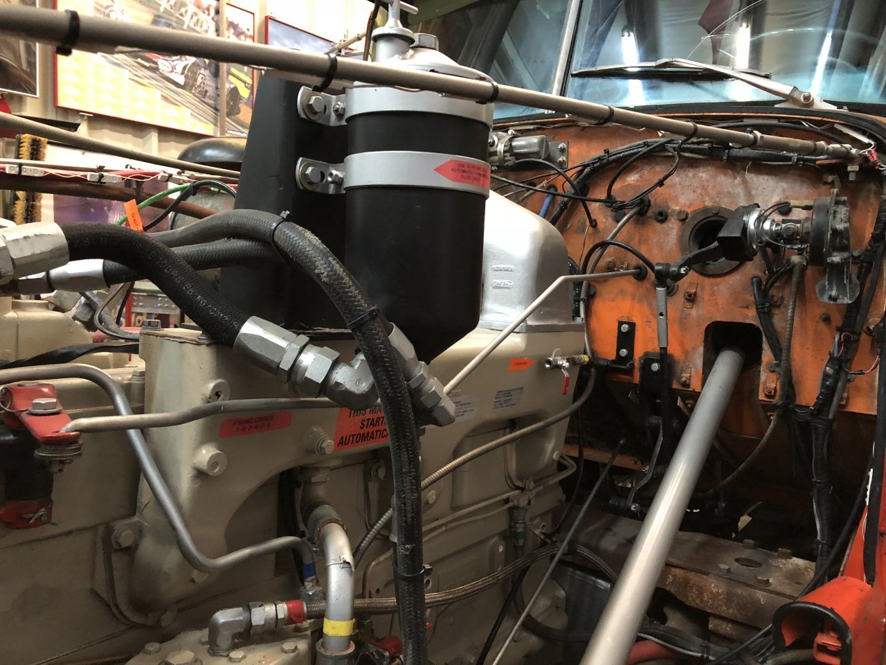

    53E887C4-AEF0-4742-82C3-27DA2AA5EA73.jpeg 4549EF08-DF52-4188-980B-DABF177F87FD.jpeg
    NH 220 in Diamond T. Heavy cast iron.

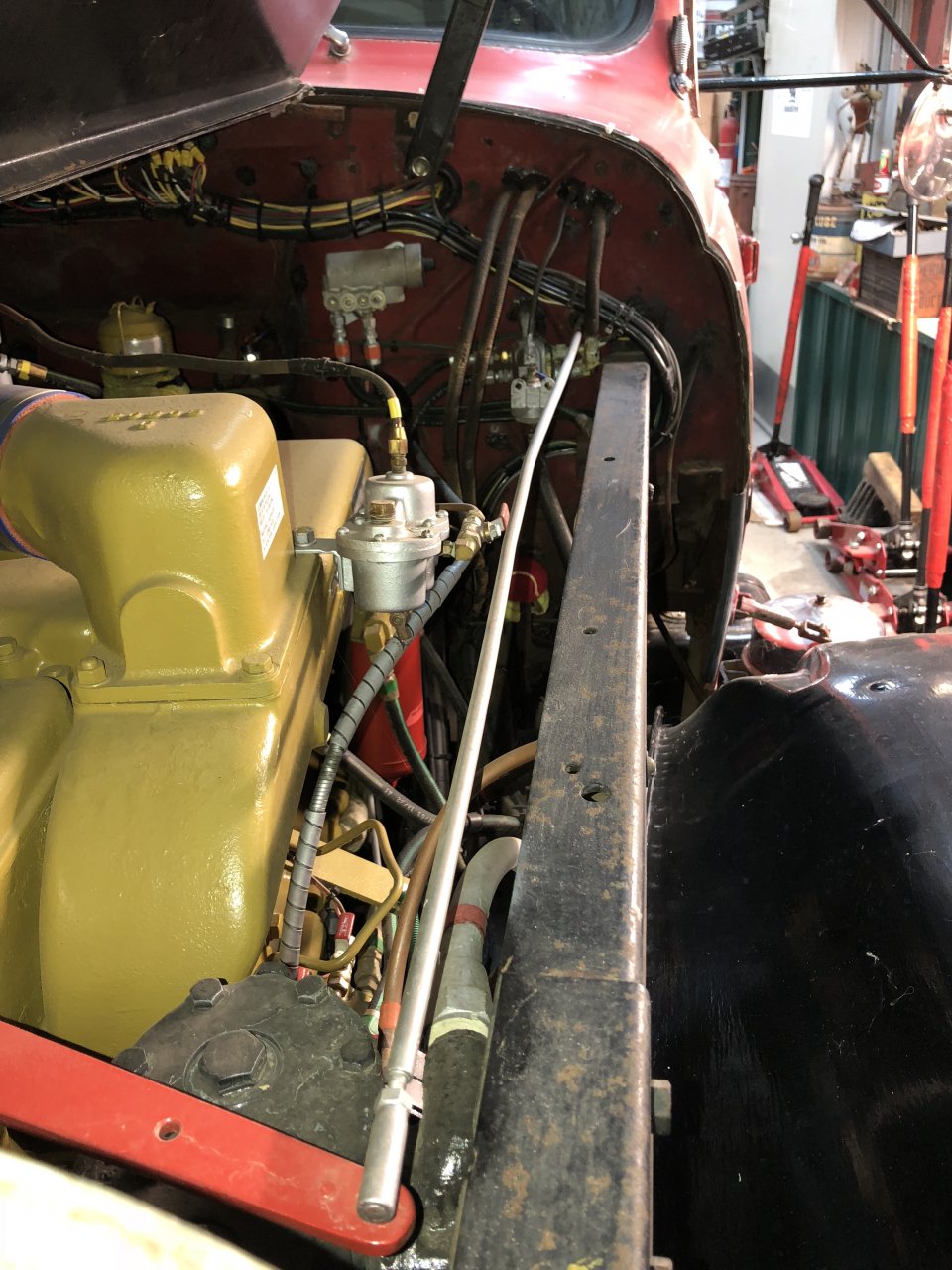

    864A958A-55D5-472D-B822-1AE0AC2F5956.jpeg NH220 in ‘64 white. This engine sits slanted to the right to shoehorn in. That is why the fan pulley sits way down low with very short belts. It is an inch away from the accessory drive.
