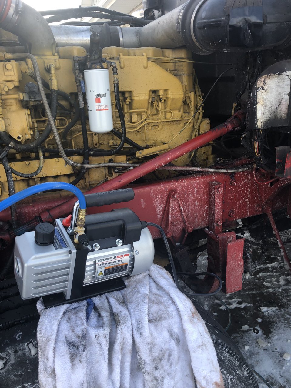

    See if it will hold vacuum

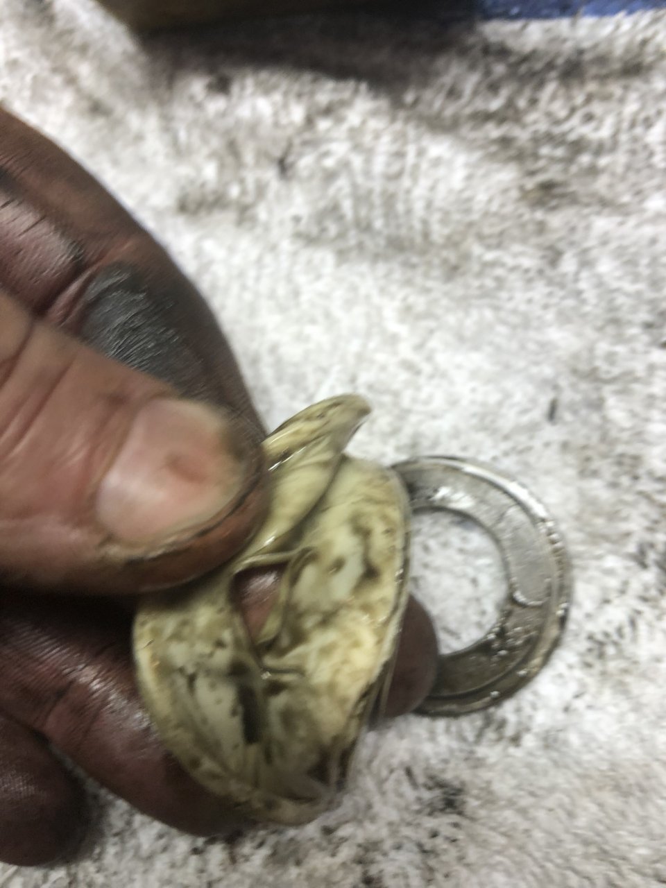

    well i made somefittings up off my vac pump and it wont pull down when hooked to thecafr, i put my thumb over fitting gage pulls rite down so i onow gage work i put on afr nuthin, so i guess put a diaphram and try or just a complete new unit?

    when i start pump it pulls mabe 3-4 inches if i leave it run it dont draw down anymore

    Most wouldnt notice that though as after it broken it was basically full fuel all the time.

    shes got a rip rite in it , thanks for the help gyes , on my way grab a new one

    I’m talking about the spool inside the AFRC. The spool that goes into the big piston
