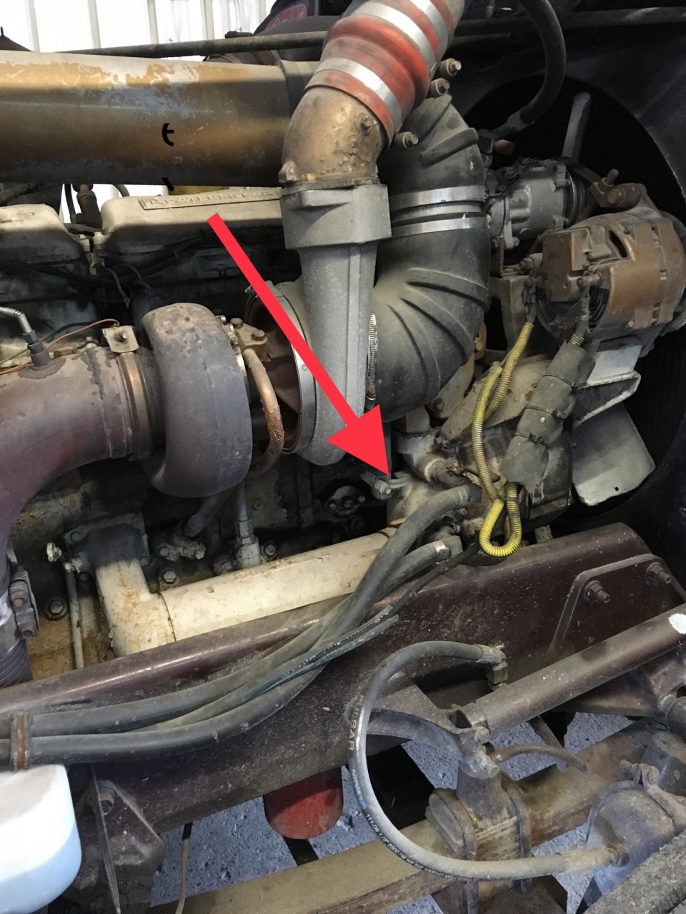

    Take the front neck off and the 4 bolts thst hold the rear to the block. Flush it with water and watch the other end to make sure all tubes are flowing a full pipe

    More then likely it will be plugged at the end closest to the rear of engine. The front end closest to water pump is suction. The rear is pressure.

    I’ve noticed I have what looks like little bits of black rubber floating in my coolant when I take the rad cap off

    Inside of hoses deteriorating....one thought. Could be clogging up your radiator tubes, but I thought I read a bit back that you replaced the radiator? That could also be a culprit in clogging your oil cooler tubes too.....

    Yep I replaced the rad a couple years ago and there was no change in coolant temp. Which was surprising since I found a shop rag in the upper hole

    Yeah, it's sounding more and more like an oil cooler flow issue now more than anything. That's the only thing left to do in the coolant flow department the way it sounds.
