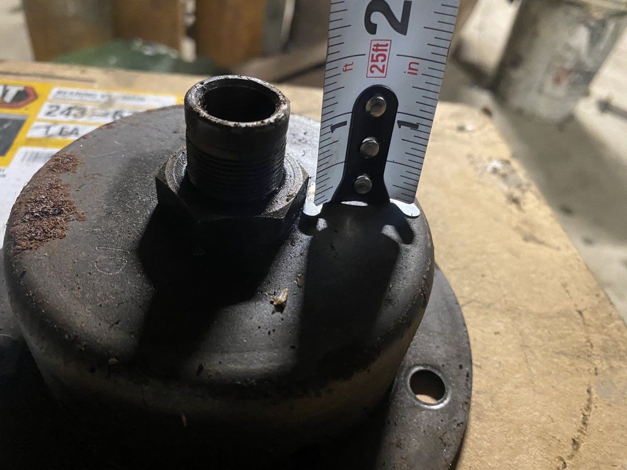

    I have a 7w3906 pump and 4 bolt advance, would start screw be set to the same 1.1 on it? @wore out

    Are the 4 bolts 6 point with a 9/16 head? If so yes
    If the 4 bolts are 12 point with a 3/8 wrench size no.
    This one you only want 4 threads sticking out of the nut. It’s also really flat face looking or cab verses the other style being more of a cone

    Mine is a 4 bolt 12pt 3/8 head, long story short alot of mistakes have been made on this 3zj and I'd love to pick your brain on it lol, is there a measurement my start screw is supposed to be factory?

    @wore out I'm sorry I may have misread your reply, on my flat one with the 3/8 12pt are you saying the start screw is only supposed to have 4 threads out?
