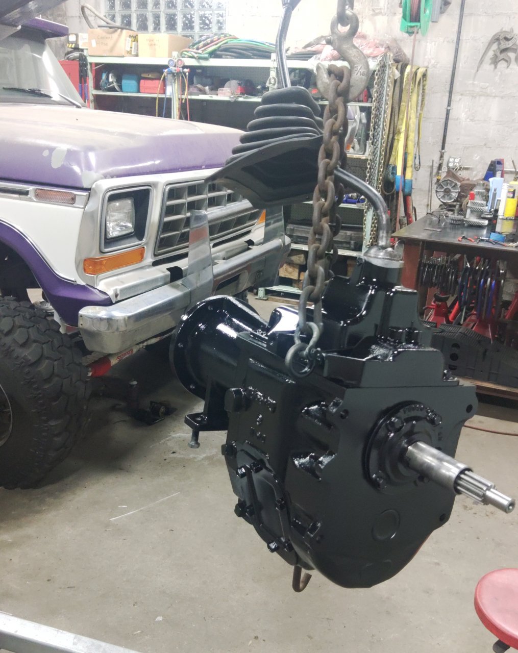

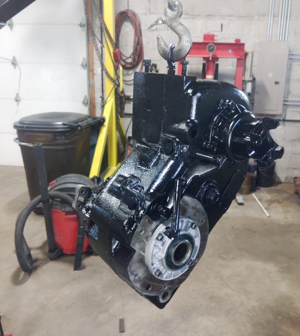

    Is that a NP205 case? It’s been several years since I seen one and do not remember if Ford used the 205 or if it was a Dodge and Chevrolet thing only

    Yes, that is a NP205 TC and a NP435 transmission. When I pulled TC out, rear bearing just felt crunchy like been pinched or debris in it. I could of just pulled tail extension, but I just wanted piece of mind. What I found was anti rotation pin for thrust washer had sheared off shaft. Glad I went thru it!

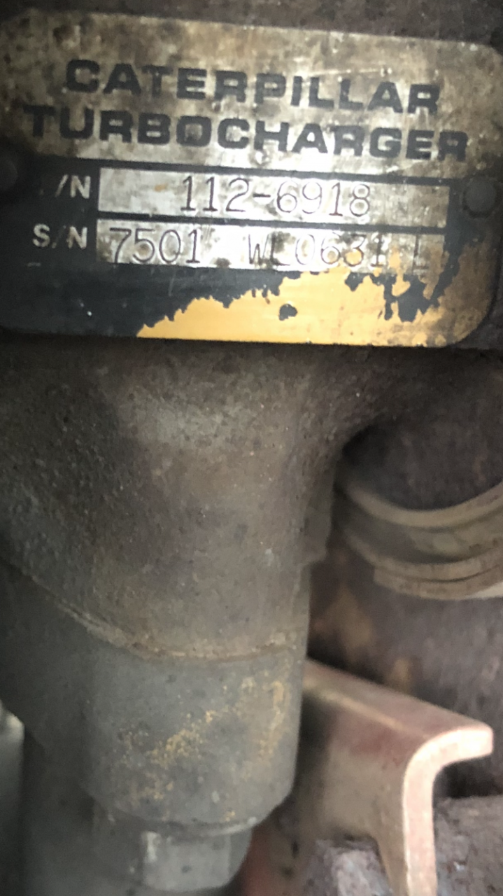

    9DF5613E-8F3B-4131-BCE7-36603B6BCED8.png I’ll just add to the overlapping serial numbers, I had a 1994 379 with a 5ek02306 E model and currently have a 1995 w9 with a 3zj51437 C model, I think it even has the original wastegated garret turbo on it still.
