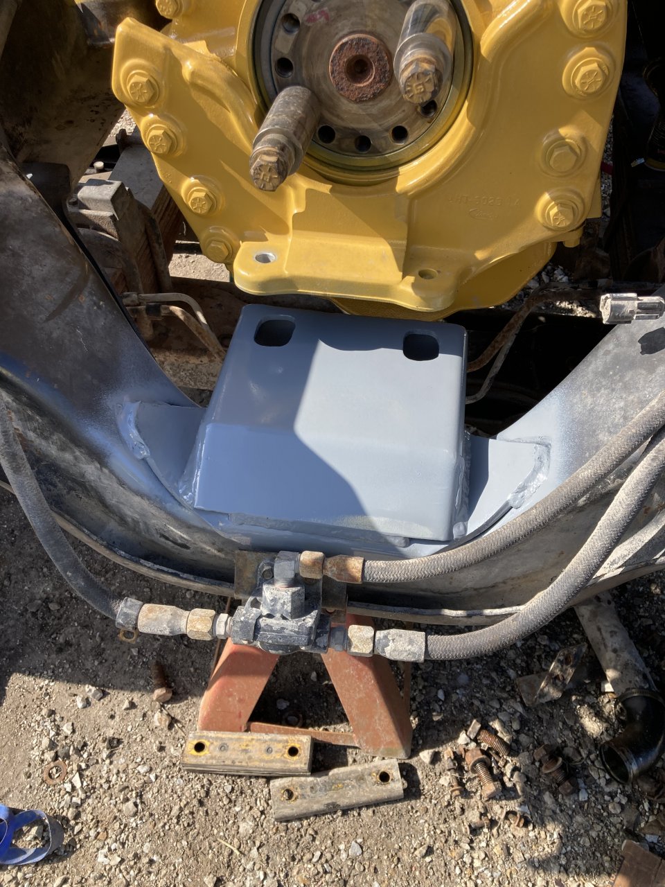

    and since ford puts their engines in crooked the easiest way to accommodate is lean the truck the other way and let the engine hang straight
    and fml some how we were off a couple inches on the front mount

    cross member problem solved

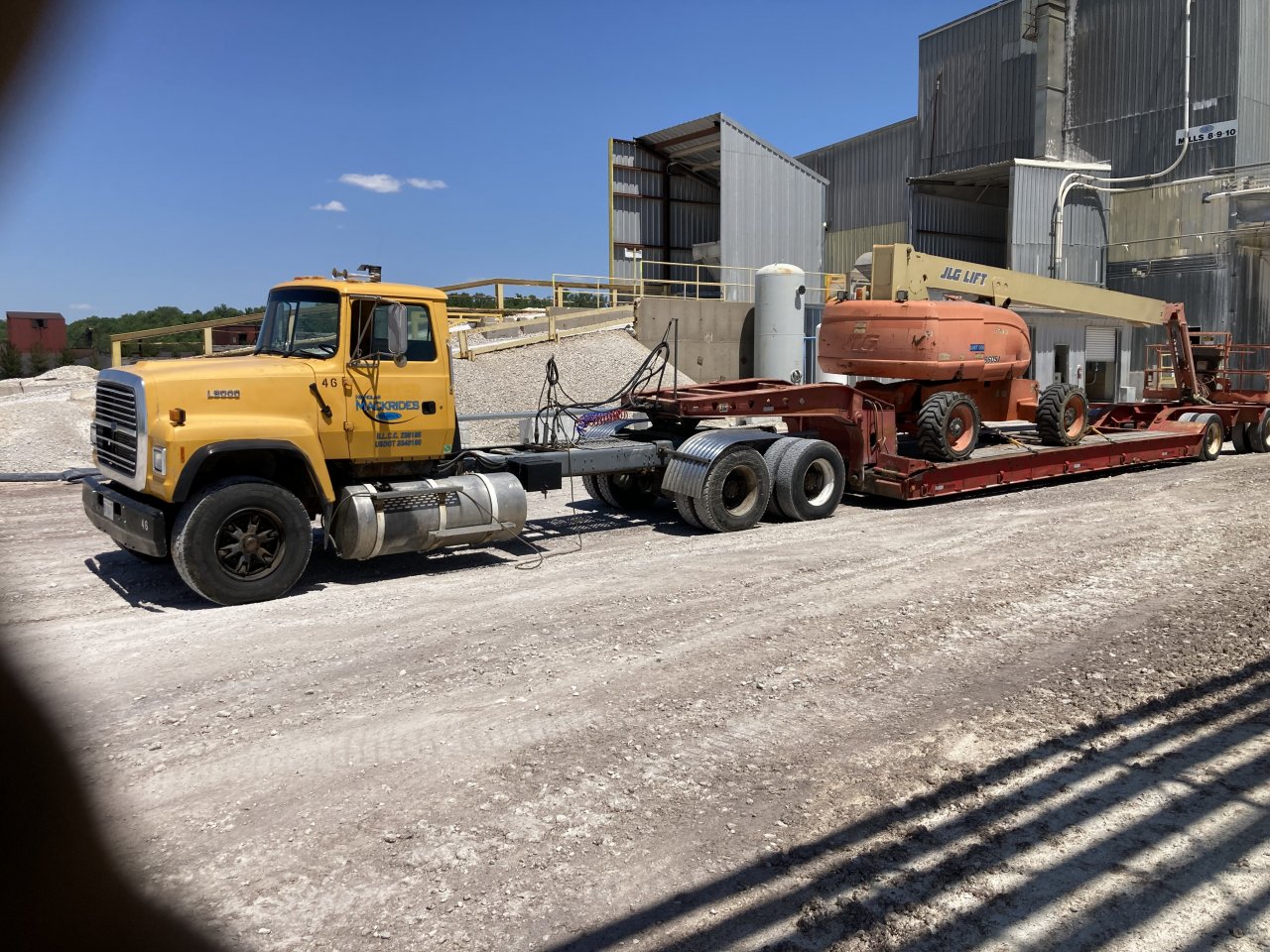

    it fits better than expected IMG_6435.jpeg Even hauled a load with it today

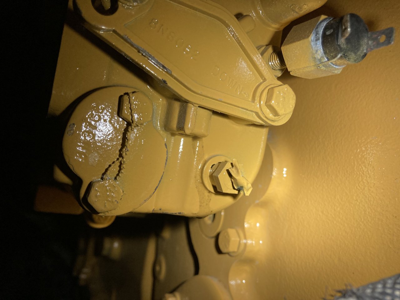

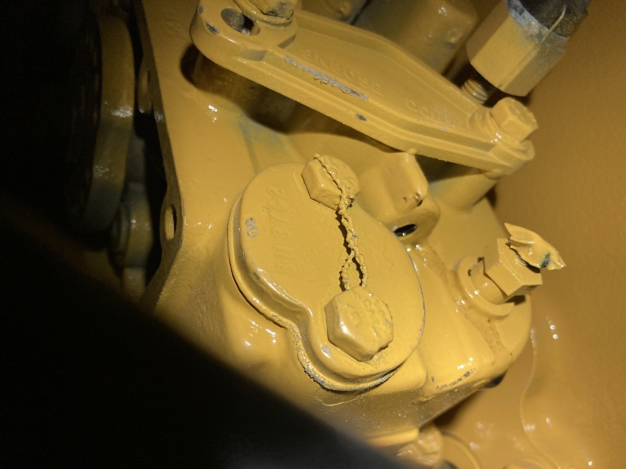

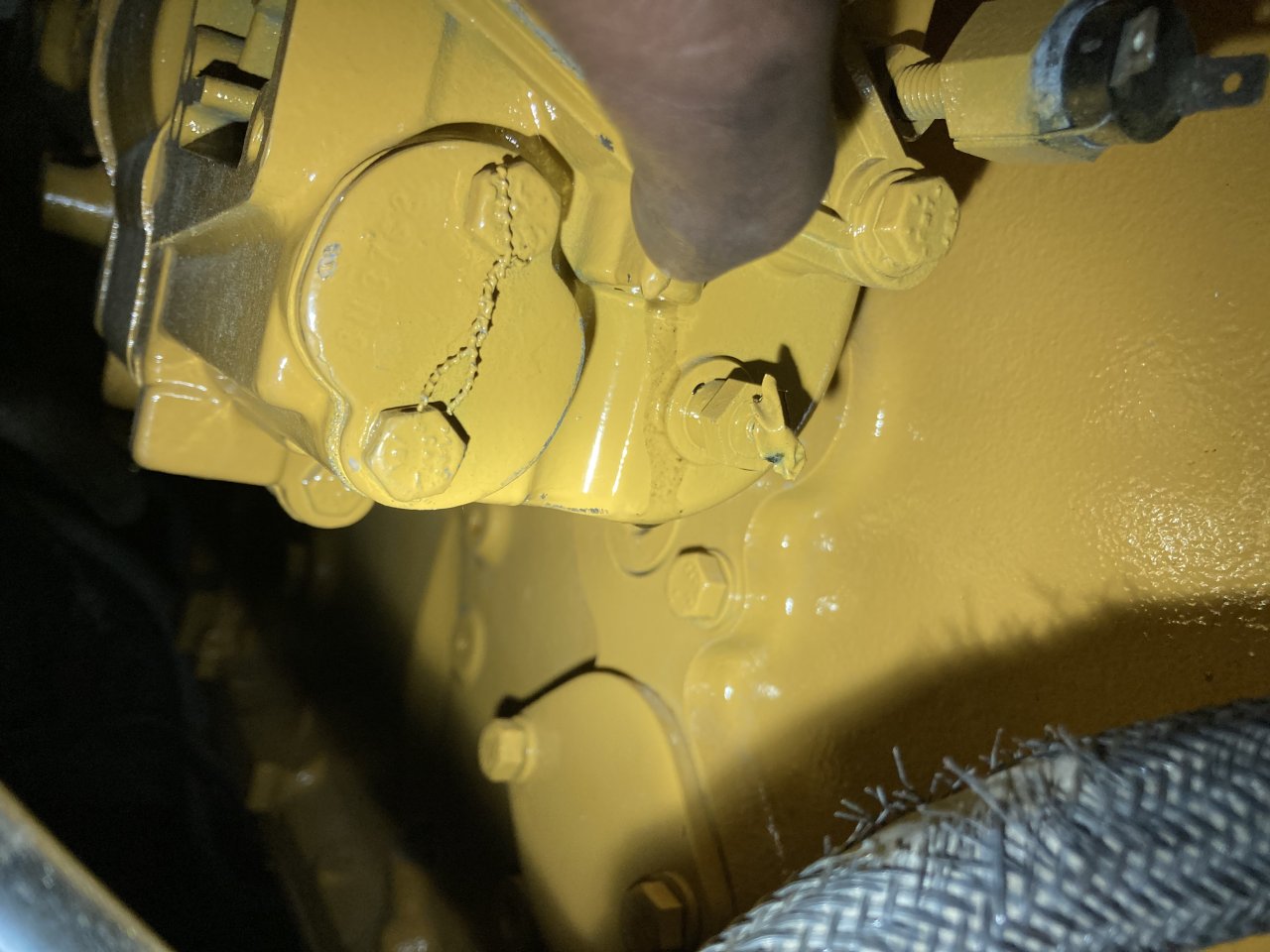

    I don’t miss that m11 even one bit IMG_6439.jpeg IMG_6440.jpeg IMG_6438.jpeg Now why is there a small oil leak at this threaded hole?
    Everything else is dry as a bone

    Tach shaft seal.
    Dry it up with brake clean put high temp silicone in it let it dry will not hurt a thing over fill anything or affect anything except the oil leak it self.
