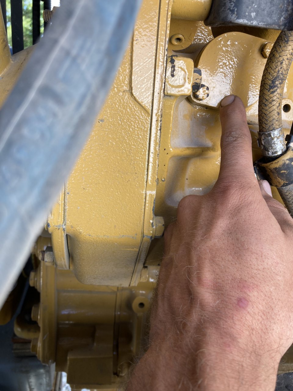

    I got the torque rise adjustment done and it was a big improvement just guessing i probably have close to 60 thousandths spring pressure. I think I must be missing something on the maximum rack travel. I took the cover off IMG_7093.jpeg Pretty sure this is the one you are talking about and I can with the fuel solenoid on push the rack bar towards the rear of the truck with a screwdriver. I then backed the fuel screw out about 7 more turns and began turning it in with just my fingers tips on the t handle allen wrench. I never felt anything but maybe I missed something….because of your comment about being too far out actually hurting power I ran it in 2 turns from where it was before I played around with it this time and lost about 6 psi boost. So the next trip I backed it out 3 turns ( 1 ) turn further than my starting point and gained back all the boost plus a little so I backed it out another turn. Makes about 35-37 and will put a hurting on my buddies isx supposed to be 550. Seems as though I have found a good stopping point. I guess since it’s still gaining I can be sure it’s not burring the rack??

    I am sure you’re fine by the boost being affected by the fine inward adjustment you made. It’s a poor boy way and trouble some the way you’re going but very effective. Still the way I set my own being honest but I’m a bit picky lol.
