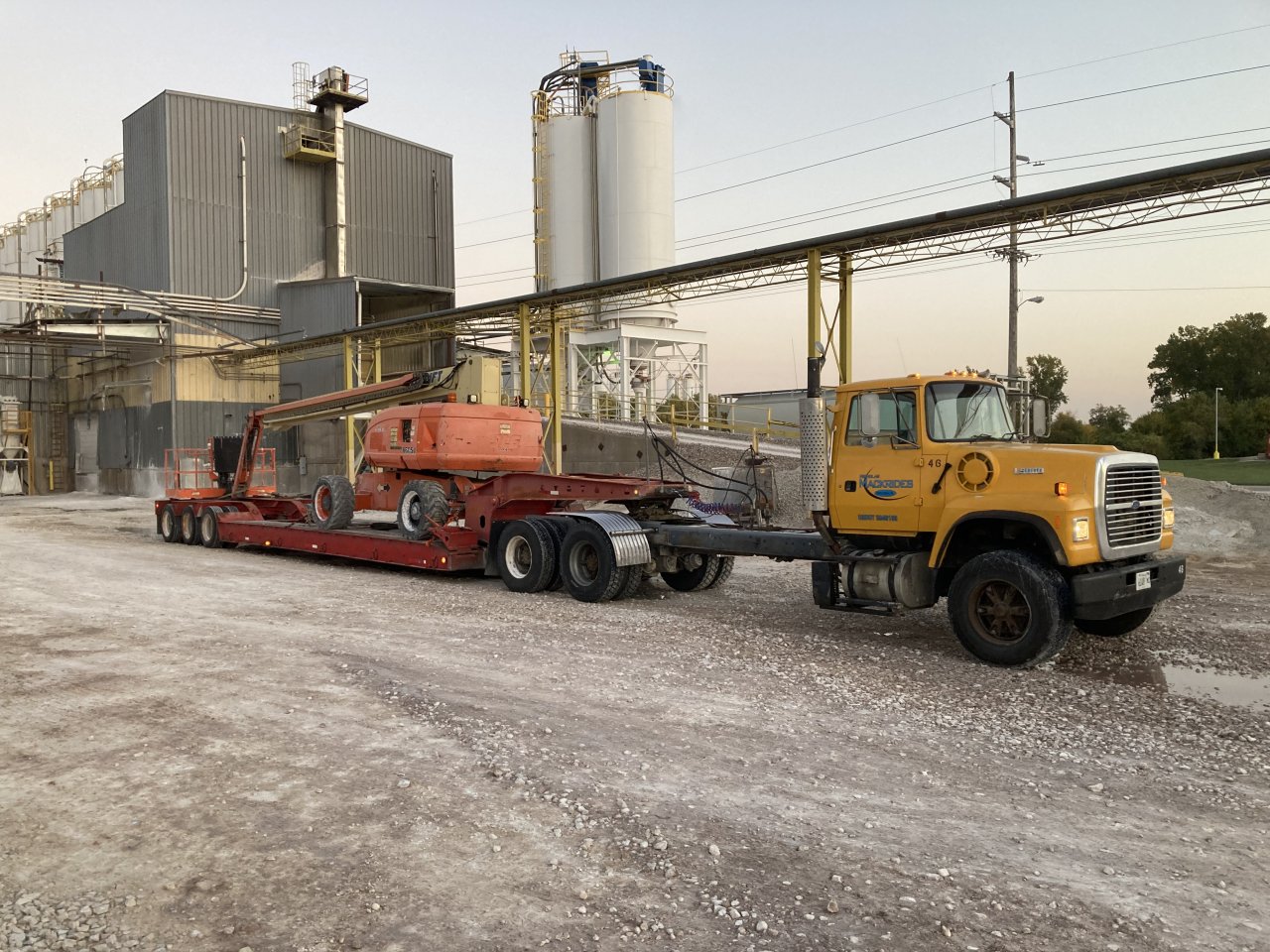

    I want some pictures of that lt9000 I am curious how big of a pita it is to work on the engine. I am thinking of switching this one to 3406 cat E1C0B9CA-85DE-4692-A0CF-3786935396B1.jpeg
    PBEtrucking and Coffey Thank this.

    I'll try and get some better pictures, thats just what I had on my phone, nut it's not bad at all really. The LT has more under hood room, a straight L model might be bad. It's basically just half of cylinder 5 and all of cylinder 6 that are in the doghouse area.
