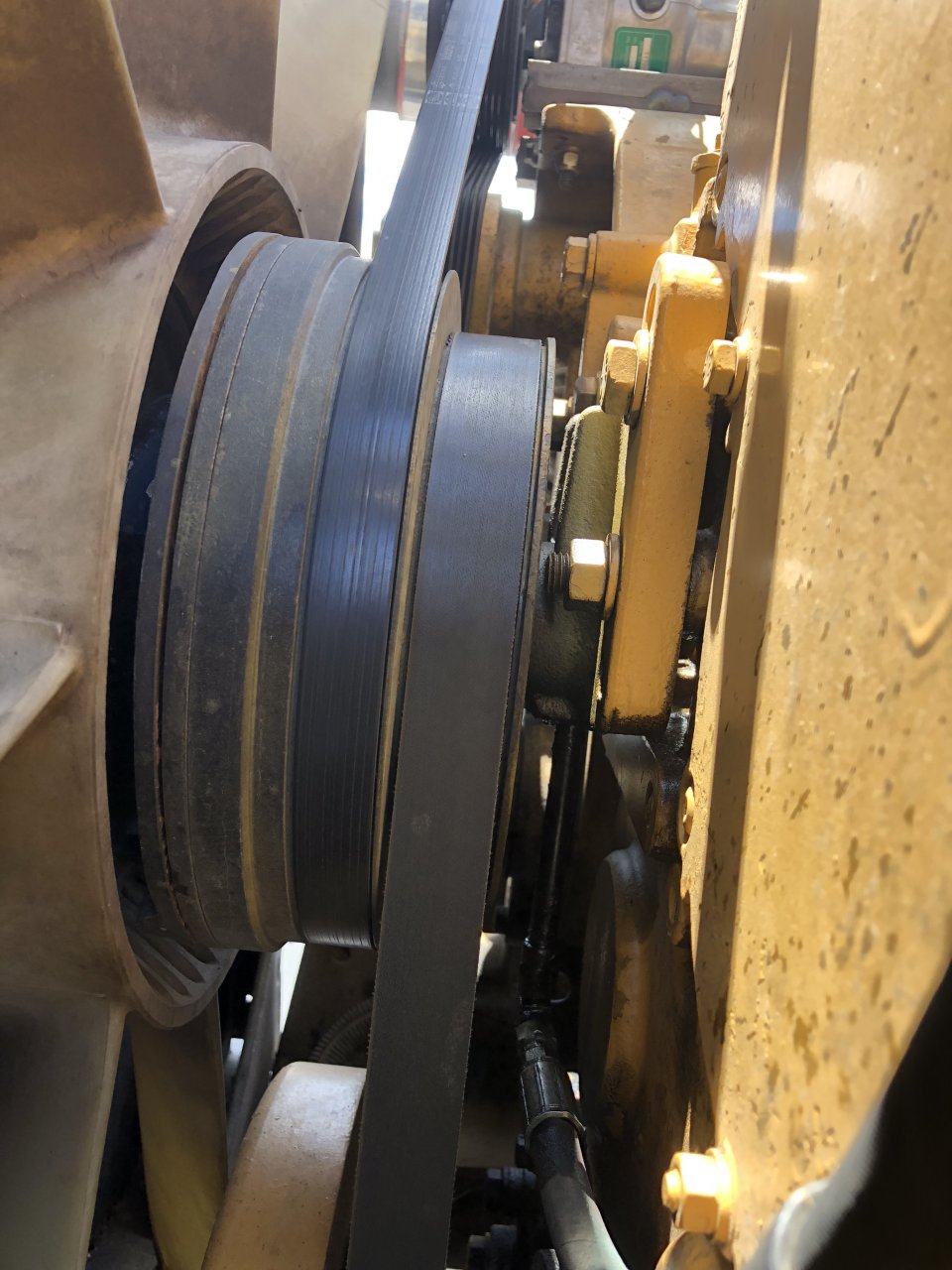

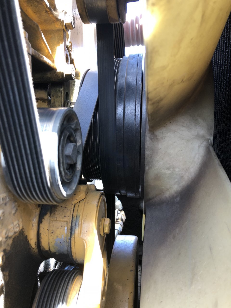

    2ADA492A-AC47-4B49-8DFD-D8CAA1C64F65.jpeg 819D7E1C-1428-456C-A1B1-566BD963CD27.jpeg Can anyone help id this fan clutch on my 2ws cat. It has completly quit working and its getting really warm out here in arizona. I can find any markings of any kind on the hub or clutch to help id it. This motor isn’t the original one the truck was built with so my local Pete dealer can’t help me I’d it. Any help would be greatly appreciated.

    Looks like a Horton HT/S 9".
