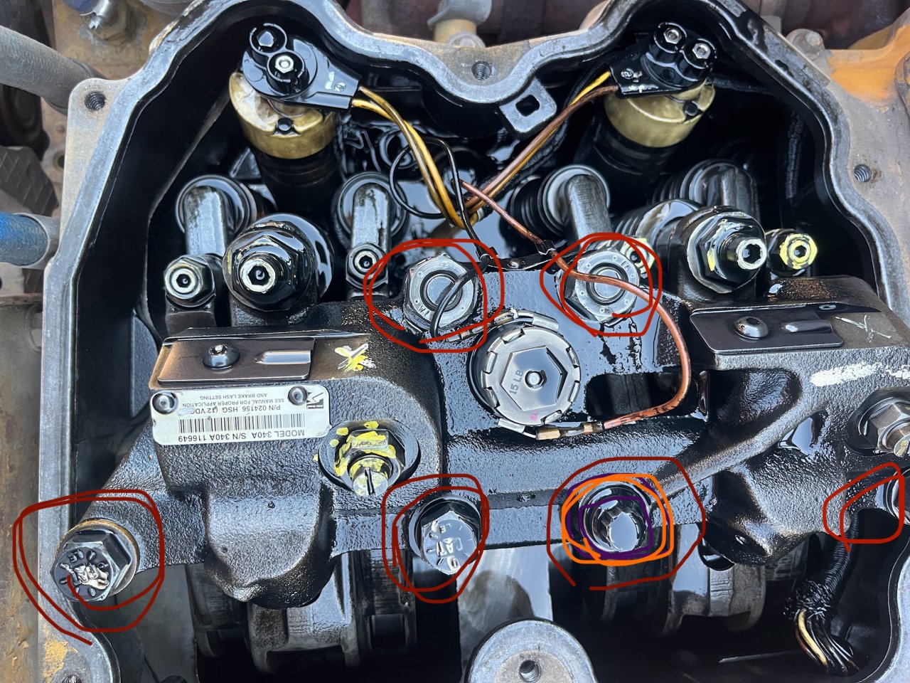

First time poster here. Was wondering if anybody can confirm if I have these toque specs correct. I am doing some fuel injector and electrical diagnostics and just put it all back together under the valve covers. My Jake housing on the 3406E (6TS) is 340A. I have 4 mounting bolts and 2 rear nuts (pictured below). I know these all have different names, but to avoid confusion I am mentioning placement.
I believe they all torque down to 80 ft lbs, more specifically 50 ft lbs - 1/4 turn - 80 ft lbs
And the valve covers bolts along with valve cover base 13 ft lbs.
Also notice the one mounting bolt is a different diameter? This is the only model I’ve seen this on, anyone know what that’s about and if it’s torqued the same? I would think so. I’ve circled all mounts, the orange and red is the smaller diameter bolt. I believe it’s 5 or 7/16 off the top of my head and the rest are 3/4” and the nuts are of course larger.

I am almost certain your cover bolts at 13 is correct though.
Is that bolt actually a different diameter at the thread or just for some reason have a 12pt headStar Rider Thanks this. -
I called a CAT shop and that’s where I got the 80 ft lbs from and they sent me a snap shot of the quick guide which had me confused for a moment. Anyway I tightened all down to 80 and honestly when taking them off they felt way tighter.

Torque for those sounds correct. I'm still in my old ways of always doing 85ftlb, but I know the latest spec is torque+angel (its changed several times over the years)
The 6 point bolts are a update for some breakage issue they had with some of the original bolts.
The 3rd one back is a original 12 point bolt and is required to be there because that bolt hole is the oil feed to the jake housing, the 12 point bolt is turned down for better oil flow.

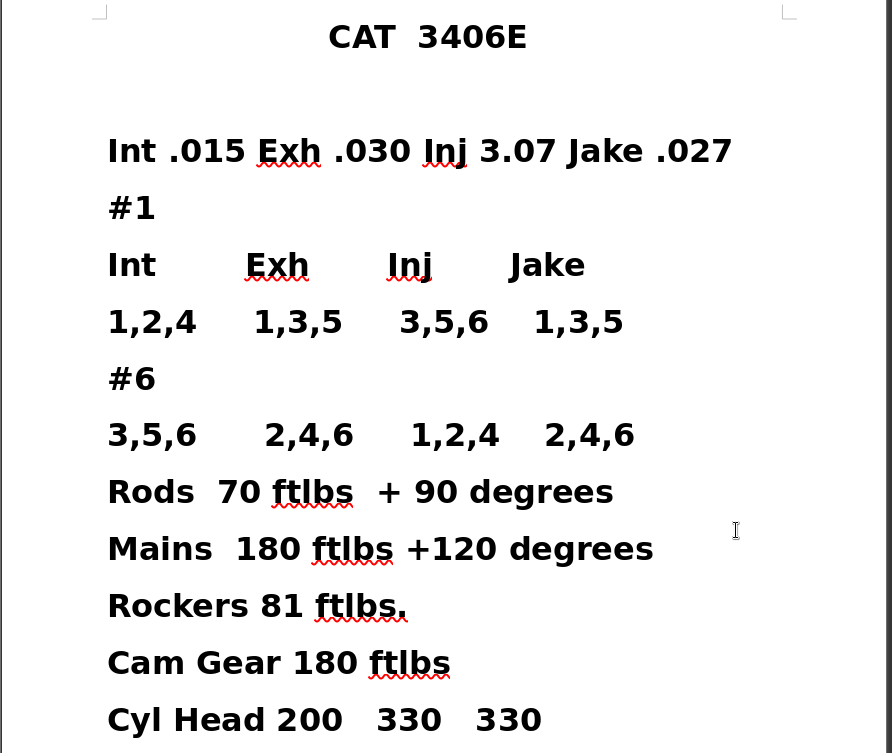

Here is a cheat sheet for you.
Th
I don’t think that any pre ACERT Cats are .027 on the jakes. Probably closer to .030 to .033
