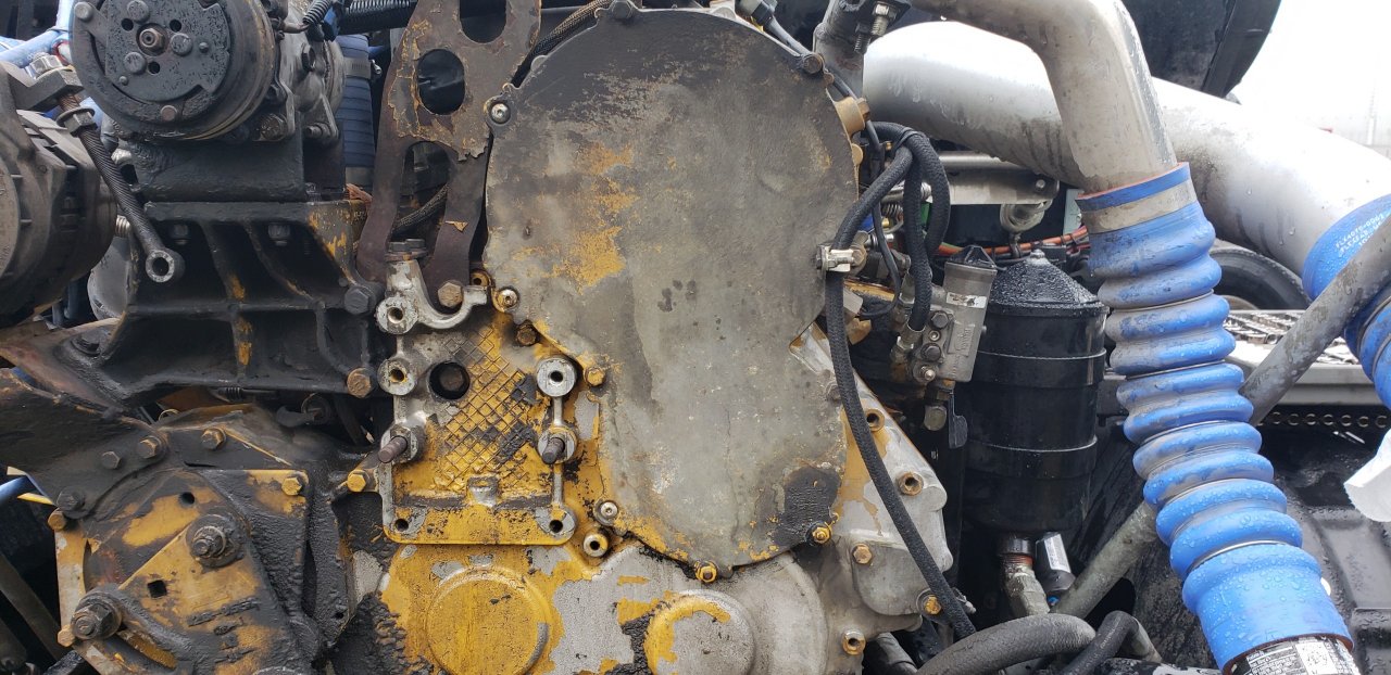

    Well this KW said they will look into it. Other KW and Pete say gear cover is included in platinum.labor. So ill see what mine KW says why they didnt replaced gaskets up front

    Big difference between the peanut cover and a front structure gasket. Peanut cover sits over cam gear, and the cover is attached to the front structure. Front structure is where the block mates to the enclosure of all the gear train. You're leaking from the fan hub bolts, because that is the easiest route for oil to follow. Band aid fix is to remove studs, slather em up with permatex, and reinstall. Real fix is new front structure gasket
    Front structure reseal is not usually included in a regular in frame overhaul. At least 20 hours of labor and a gasket kit. With the new inflation adjusted math I would probably expect to be charged 30 hrs for the job.

    Cat wants 35 hrs. 3 years ago i replaced fun hub. Before and after it didnt leak any oil till local KW did inframe. Are you talking about these two studs in my pics. What about two bolt right under stuts and 3 above studs ?
    Also what that bolt that sitts inside that hole is for ?? Does that bolt goes into the front on head ??
    If that bolt holds front gear cover to the head, maybe KW didnt see it and thats why they had hard time pulling head off

    Platinum overhaul doesn't include front structure kit and would have been extra cost but less labor because easier to do during overhaul. Clean it up and find/ verify actual leak start point, saves a lot of grief. I'd replace the viscous damper if older.

    I was advised by cat that the front cover was not included in the Platinum. I had the same issue, oil leaking from behind the fan. Had the front cover done and they found one of the gear bearings cracked. 20220409_121237.jpg
