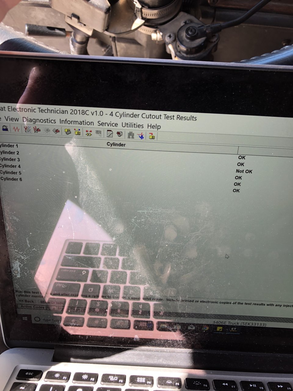

  8. JCMtrans
    JCMtrans Bobtail Member
    45
    27
    Dec 29, 2016
    I don't know how my reply showed up as someone else's. I really don't... The above is me replying to Everluc..... Above is also a photo of the 4 cylinder automated test results that showed #3 as not ok...until now the automated tests didn't show much except low readings for #3. This is the first test I've done where the automated tests have actually caught it.
  9. Troy_
    Troy_ Road Train Member
    1,070
    7,362
    Dec 13, 2017
    Roma, Alberta.
    they didn't track it down to a specific cylinder like in your case, Truck309 mentioned there was a bad run of reman injectors in 2012 and we talked Finning (the Caterpillar guys up here) into replacing them after they admitted there was in fact issues with some injectors. the tech that came to our shop to replace them discovered that every injector had burn marks past the tips from blowby and inspected the seats with a borescope. all of them were badly leaking past the tips and Finning agreed to replace the head. a poster here on Truck309's thread, truckmachinist I believe it was, said from the start it was injector seats, in my case he was bang on. he had built his own tool to re-grind the seats after he found out this was an issue on other trucks with the exact symptoms my truck had.
