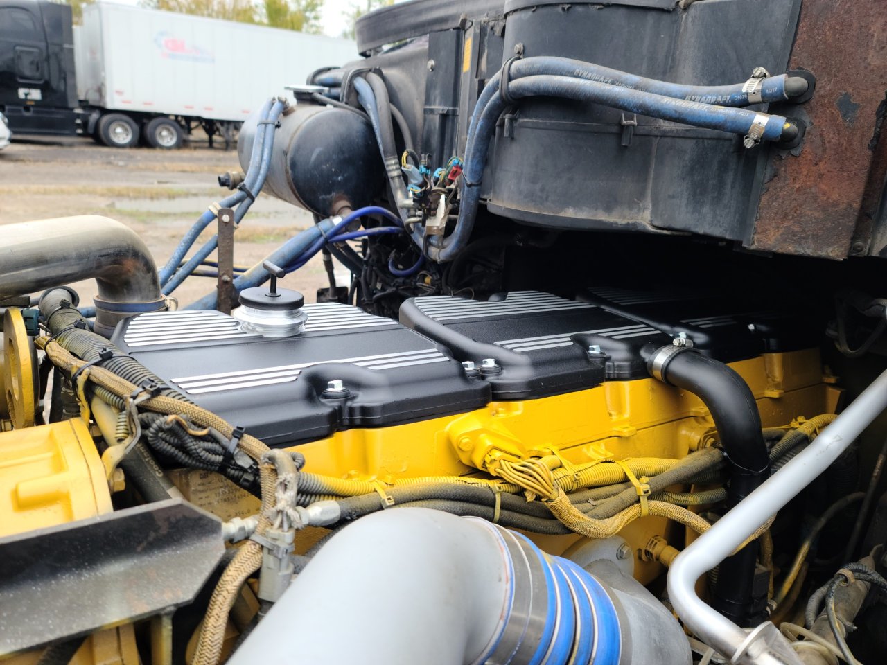

    I have 1999 3406E 1LW. Just did platinum in frame overhaul. To make it nice i installed new valve covers. One of them is 6NZ valve cover and breather tube. Now, what should i do with my original setup that have breather on side of the block. I can plug it up BUT there is sensor on breather box, i think its crankcase pressure sensor, cat cals it Sensor GP pressure. I have that sensor on KR ScanGauge and measure 14.5-14.9
    So if i plug breather box will it screw up reading for this sensor ???

    The 1lw I had started blowing oil out of factory vent port on side of block at a very rapid rate. Top 3406 mechanic at cat dealership truck engine shop instructed me to buy valve cover with vent tube and plug original hole with cap the appropriate size with rubber plug that expands as you tighten it. Ran it several years after that with no issues and no other needed alterations.

    I think the sensor you are referring to is your atmospheric pressure sensor. Not related to blow by tube.

    No modification of any kind no. In my case the way I understood it engine had came to a point of creating enough crankcase pressure to push oil out of factory location. Mechanic said bad design location plug it and keep going. After doing so had zero issues.

    I tkink its called both chankcase and atmospheric pressure sensor. It sits on breather outlet right before breather hose. Its 3 wire sensor and i read somewhere if sensor gets bad, ecm goes in safe more and reads 14.5 or 14.7 by it self. I just want plug breather hose and have sensor start readinv wrong i waist all money i just spend on platinum inframe and all other parts that d8dnt came with platinum kit

    Does anyone know what size twist drain plug is needed to fit breather outlet on side of the block. Looks like its bigger than 1" maybe ???

    I don't remember the size exactly definitely thinking bigger than inch. Maybe inch and a half. I would call a cat shop and ask. Anyone there who has been around for awhile would know what is needed I would think. Or just measure the hole get one as close as you can find and hope for the best.
