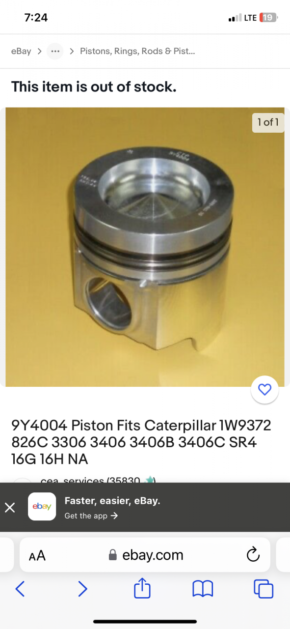

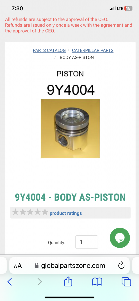

    Who told you the 9Y4004 is steel top they are 1 piece aluminum. No such thing as steel tops for a 3406 road engine till the 8PN. With their bowl design I’ll stay aluminum. No reason a 1 piece aluminum won’t stand the pressure till 600 anyway. Also do not take the screws out. If you go past the max travel limit with the fuel screw it allows the rack bar to hang on the end of the scroll gear. Starts a burr then you’ve wiped a pump cam out. Pull the torque rise screw and you’ve lost your torque rise and half the usefulness of the full range govnor that made CAT what it is.
    just a little info for those that think you can just turn a screw. Every turn you turn that fuel screw the more fuel it passes through the plunger. Which winds up on top the #### plunger. Every time that plunger comes up to fire it it beats the living piss outta the pump cam. Bout 2500 a whack just for the cam. Same as turning the rail pressure up on a Cummins sure it runs good but not for long. Risk and reward
    Now there are good options in the industrial line. I had 1 B model with 3412 pistons. But the bowl is wide so you run a 3425 nozzle not a 3421.
    I hear all the time cuz I heavy haul I need more. The 400 is a fine motor. Build it to spec put air to air on it and an N14 turbo and leave it alone. It will live otherwise put heads on it weekly. Lots a big #### was moved with a shiney 290.

    No it’s one piece aluminum. A little hint when CAT calls it a body assembly or piston body assembly it’s 1 piece. There is no 1 piece steels so….
    I have idk how many in the scrap pile behind the shop. How many would you like to see that a magnet doesn’t stick too. CAT doesn’t offfer the 9Y4004 any more it’s updated to a 1W9372.
    Just a quick google search of said number and dozens of aftermarket pop up here’s one and guess what it’s aluminum
