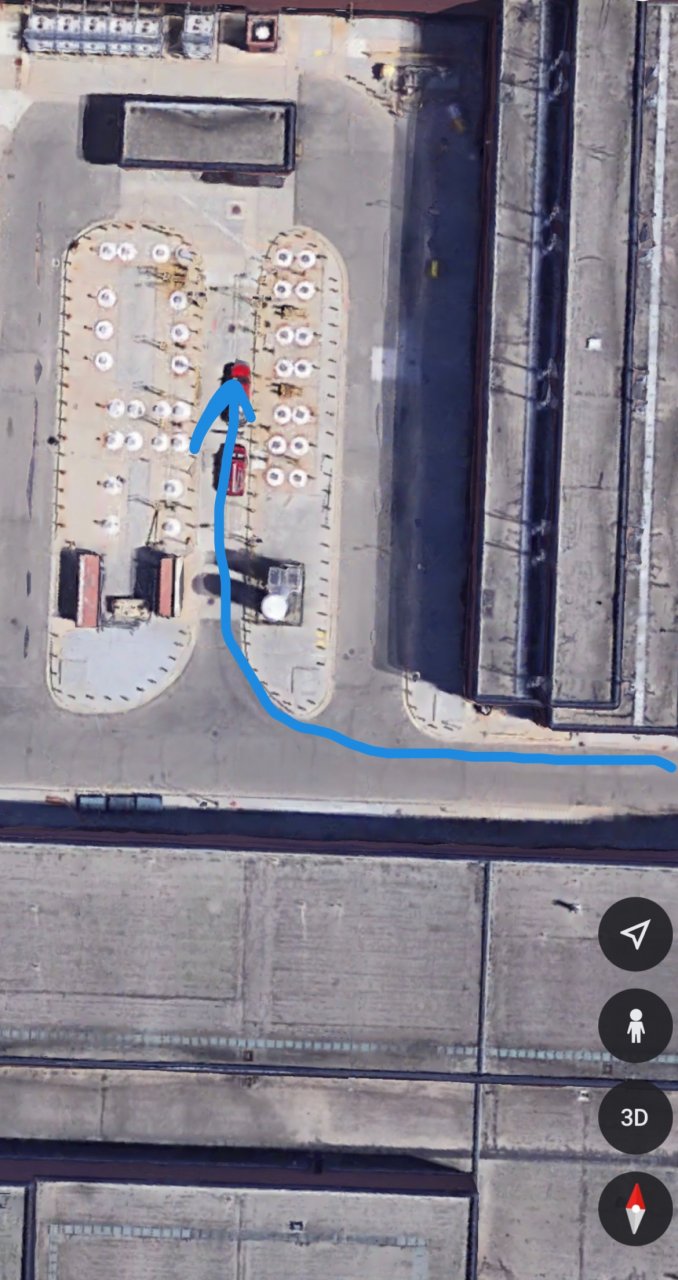

    Generally I look at if I have more vertical or horizontal space. If I have more vertical space I do a 45 as it’s much easier in my opinion. More horizontal space I set up a 90 but all situations are different. I make sure to use all space available to make life easier. I’ve only driven tankers so I’ve been lucky.
    this spot for example very horizontal. No way to set it up other than a 90 gotta pull up sit in the middle then a slight turn to the left as you stop.. back up a few then straighten the truck and let trailer do the work... it’s pretty narrow on both the alley and lane you pull in with bollards all around it. Have to stay close to the curb with the trailer wheels without hugging it then jack it just a little to miss the bollards on the other side. If you do it right you can do it in one motion.(that’s a good day) most days when playing it safe you come back a second too late to make sure you clear everything the trailer turns a little further than needed and you have to pull up and slowly blindside it away from the curb. It all depends... every situation is different
