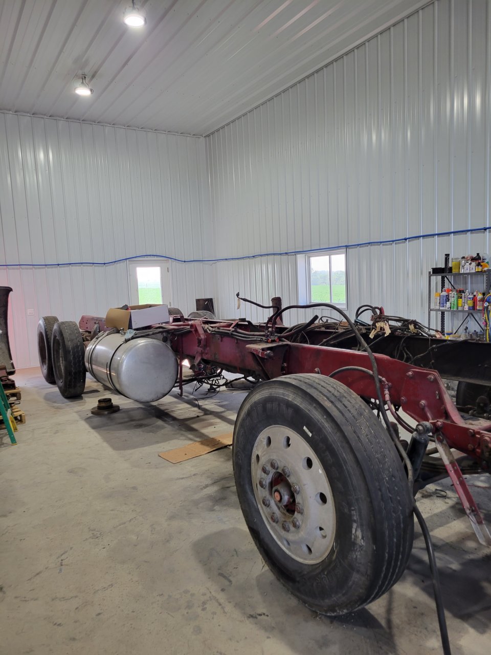

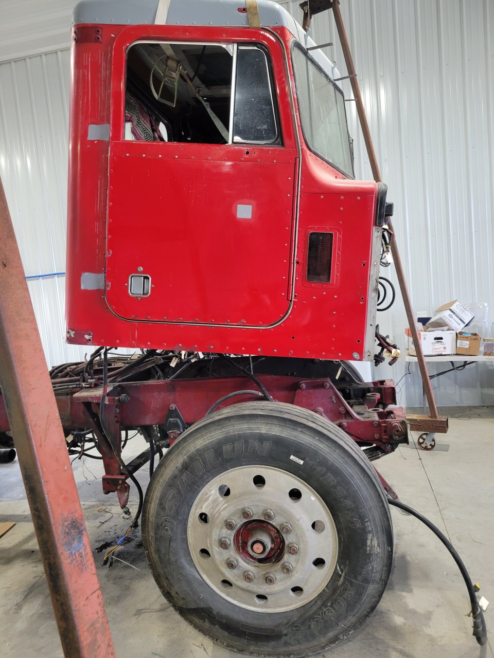

    Easy Peasy if you've got the lifting equipment, which you do. I'd suggest buzzing together a spreader bar for the pick.

    And then picking from underneath I gather?

    Yep. Takes a little field engineering to not squish anything. Some Coors and a couple buddies is a BIG help.
