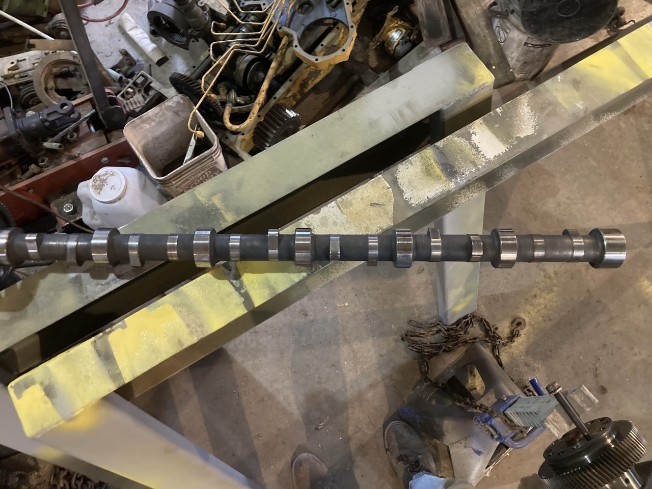

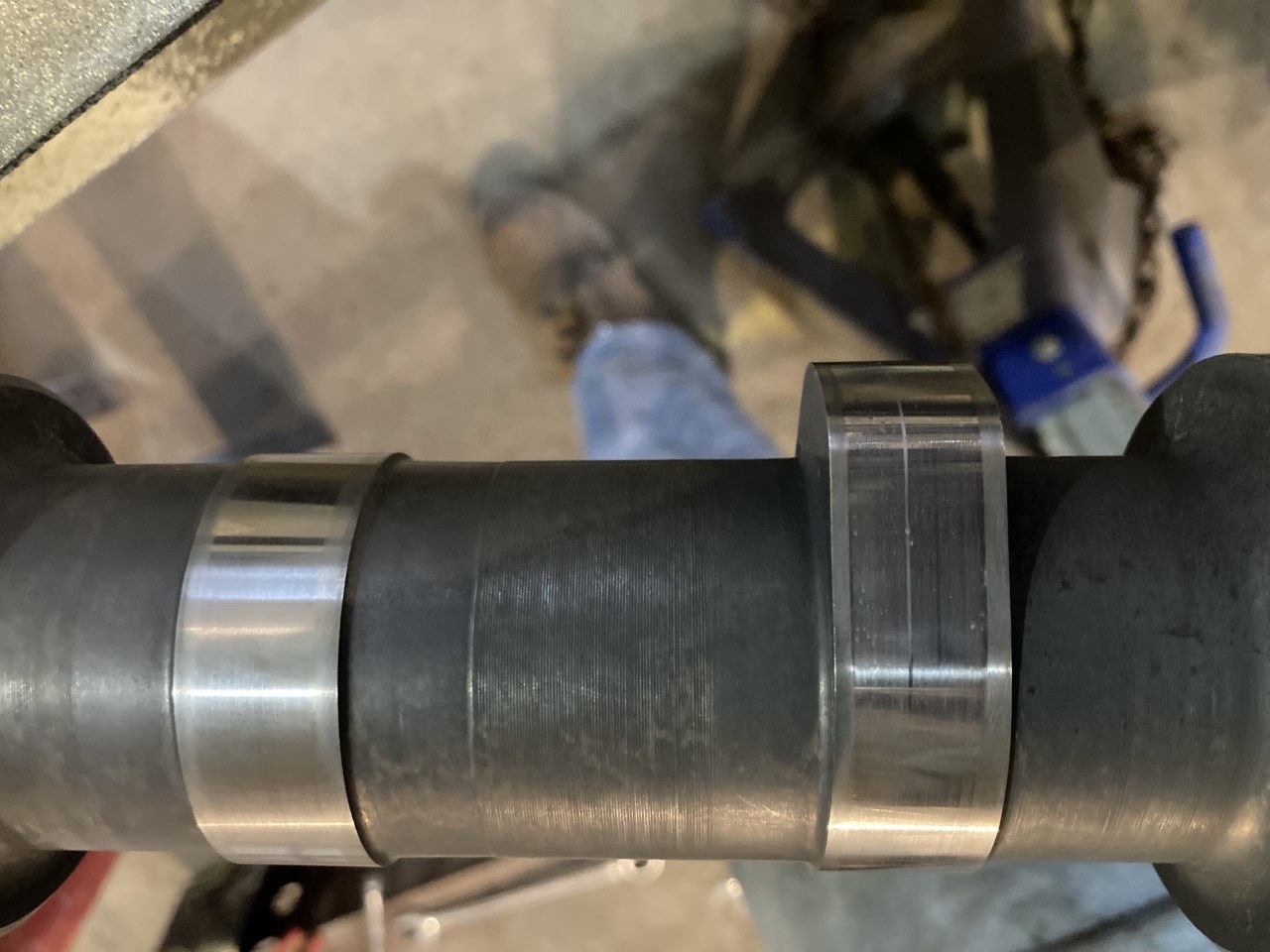

    tempImageLGmQL6.png The 4W-1765 has a long exhaust duration, But the ramp is fast as you already know.
    8A1787A1-9EF6-4682-95A9-278B5C81C4E8_1_201_a.jpeg 519B61F5-8452-4246-B935-C325459B0319_1_201_a.jpeg
    When I have the time, I'll place both cams on a stand with a Degree wheel on them and compare the two, 4w1765 vs 7W-3796.
    Installing a 7W-3796 in the Pete starting tomorrow. Dropped a lifter on #5 exhaust and tossed another down the hole on Monday to get by for the week. Have all my parts and after I finish working this evening I drop the pan and front cover to do a swap. tempImageRXSMTY.png The 7W-3796 is the same profile as the 100-7048, when these camshaft are remanned for CAT They use the file to grind.
