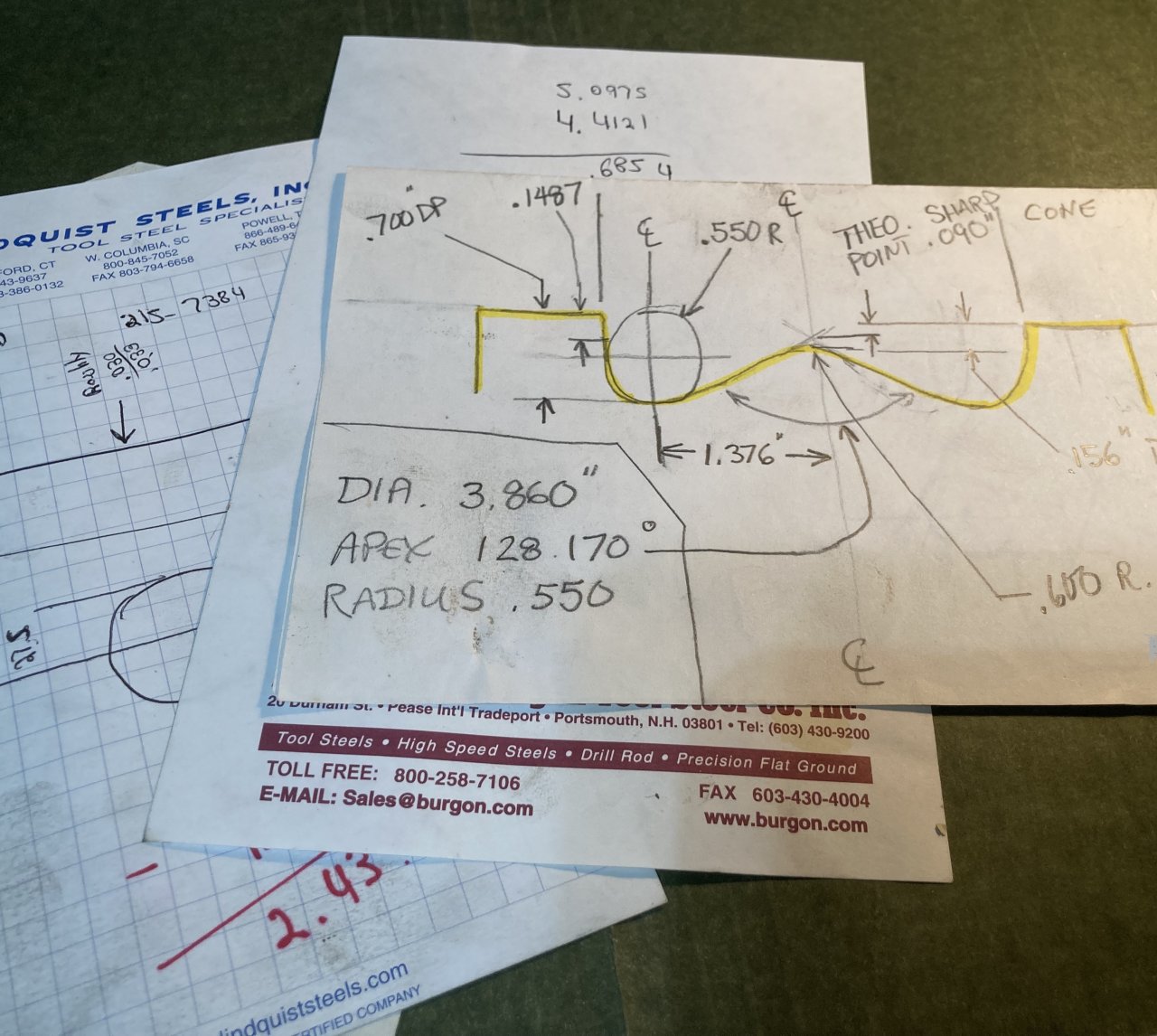

    As far as piston & injector matching, I was just going to use a new set of 130-5187 injectors that I've had good success running for the last 12 years with modifications to the pistons using a CAD program I made years ago. 365D27EF-55C0-4534-921B-CE4B01549707_1_201_a.jpeg

    Assuming your gonna use the IPD 17 liter pistons do you know they will live after being machined or are you going to loose too much in the bowl and run the risk of being too thin?
    Cause it doesn’t matter whether your compression is 14.6:2 or 16.1:1. It’s about bowl size depth and taper. Getting the spray at just the right time and position to atomize properly other wise your just making smoke and heat. Those nozzles have a crack pressure at 3500 psi……takes a C pump to run them unless you lower the pressure which affects atomization. And you need to know what parts to put in that C pump cause it can’t be stock. It’s a mixed bag of ####. When you get it to flow enough you loose fuel pressure on a pull so you have to supplement the lift pump with a pos fass and in that it causes you to carry a spare motor around for it. Every one says that it takes a B governor section on a C to get that flow but that’s not it. Or at least I don’t think so, I mean I don’t for sure I knew a guy one time and that’s what he told me
