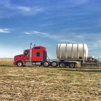

    I've stumbled upon an opportunity last week to run 3 T660's with 2 drop axles on the power units. The trucks are 2012 T660s with a total of 5 axles and a wheel base of 305 (I'll include a picture). They currently run grain from the field or farm to local elevators in SD but I will be trying to take them OTR in the coming months. I've received some backlash as to who would install an additional tag, I understand in a lot of situations it's just 2000lbs of dead weight and having enough weight on the steer axle may be a problem. However the trucks run winter roads throughout half of the year and we haven't had too much of a problem navigating the them around corners. Regardless, I am looking for some insight on where to get started, they are still 600hp pulling machines that can get from A to B. Being farm trucks they all have less than 100,000 miles as well. What would be a good industry to look for loads in? Thanks for the help. Inked13438836_10154966112908136_7038476233437744228_n_LI.jpg

    It appears as if you already have a step-deck, so that would seem to make sense to me. You will not be able to take as heavy of loads as a typical road tractor due to the excess weight of the drop axles, but there are many loads that do not come close to grossing out.
    You say they are farm trucks, so make sure that you acquire the proper authority, insurance, etc. to haul non-exempt commodities for hire.

    I have one lift axle on mine, 2008 ProStar, 600hp ISX up front, 18spd, wet kit, and it is heavy with the set back axle. A set back axle rated at 12,000 lbs. They could have at least spec'd a 14,000 pound axle up there. And I do use mine, but rarely, as most of the time I'm well under 15,000 lbs in the dry van. It is a steerable unit which is nice, and is rated at 8,000 pounds. But, when I do get those 50,000+ lb loads from Ford Axle trust me it comes in handy. Thank God it is only a 10 mile trip.
    But two, a bit overkill unless you really need them. Even in the oil patch in ND one lift axle was plenty for what we do. And that was the reason for my truck purchase, it was going to go to work hauling Propane and Butane in the patch. That dried up, and now running auto parts in Detroit and surrounding area. But, that axle is a good conversation starter, I tell everyone I'm new and those are my training wheels. ;-)

    What are you running that requires two lift axles? I really do not see the purpose unless you are specializing in something odd.

    We run 9,000 acres of corn/soybeans with 4 guys total. The heavier we can load the trucks, the quicker we get done.
