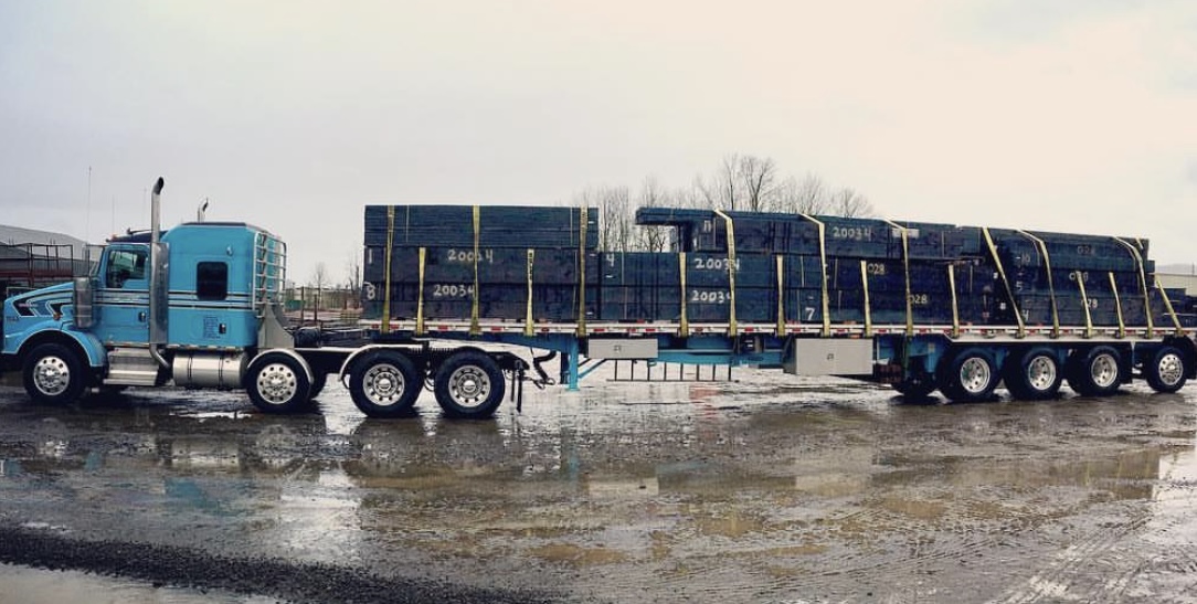

  8. Long FLD
    Long FLD Road Train Member
    13,230
    55,654
    Mar 4, 2015
    I don’t have many pics straight on from the side. This one bridged out at 105k (102k in Oregon). 5th wheel is centered over the first drive axle, 10ft spread on the lift, 12k on the steer axle. I had room to slide under the trailer to get more on the steer but if I did that it would cut weight from my 7 axle bridge so there was no benefit. Your 7 axle bridge is what will determine your overall gross after you max it out.
    If you can get your 7 axle bridge to 57ft and still carry 12,500 on your steer while loaded then you’d be good for 105,500.
