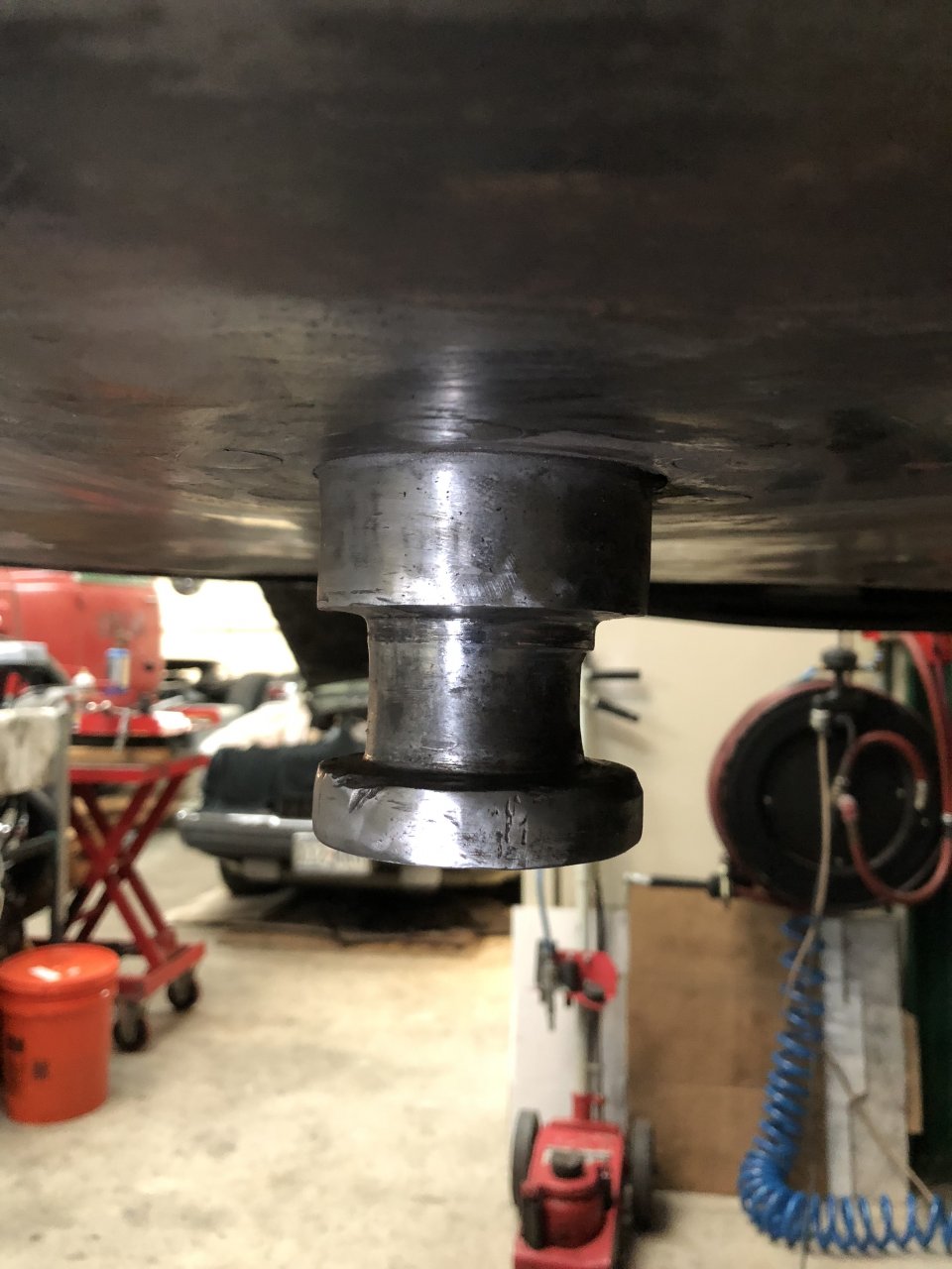

    This is the pin on my 1950 Fruehauf flatbed after I sanded it clean and got some burrs out of it from being hit hard too many times. It is 70 years old and who knows how many miles. Still in spec according to Utility and the test gauges. It’s worn down about 1/16 almost 1/8 of an inch on the 2 inch collar on the pull side “backside” and still sits tight in the jaws.
    I adjusted the fifth wheel to the new pin tool I made and it had a little play in it so I did final adjustment to it. I have not had a problem pulling the handle and getting loose from any other trailers.
    I painted it orange before I greased it up for an experiment so I can watch it and see where the witness marks end up. So far so good. No extra alarming wear happening yet.
    If you look close enough at the bolster plate you can see a couple of the counter sunk heads of six of the 5/8” rivets that Fruehauf used to install the pin. It is not welded in and is still solid.
