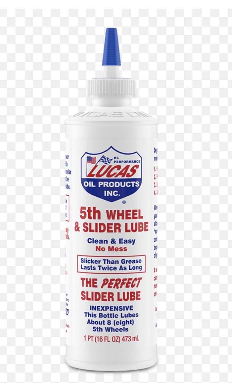

    I tried a bottle and wouldn’t bother with it again. It works fine in warm dry weather but not very well at all in cold and wet. It’s got a strange chemical property that won’t allow it to adhere to a wet steel surface at all. Just kind of smears around like silly putty and won’t stick to anything but itself. And getting it out of the bottle is a joke once the bottle is down to around half empty.

    Yea. I’ve noticed all that. I drop and hook and noticed when I drop, the plate is dry on certain spots. I basically have to lube b4 hooking up to another trailer each time. I think the lube stays on the trailer, not the fifth wheel. I’m also on the Southern West Coast, gets chilly but it’s still doable to squeeze it out. And buying it by the case, is a lot less expensive than purchasing individually. Overall, it has its Pros and Cons.

    Now a great product for this they unfortunately discontinued is Amsoil’s 5th wheel grease. It came in what looked like a giant white tube of toothpaste and was just as convenient and mess-free to use, so it could easily be stored in the cab to keep it at room temperate. Top quality GLI #2 synthetic oil based HD grease (5% moly). Better than typical red-n-tacky for heavy duty pivot points. It was metallic grey colored. There might still be some old stock of it still around on eBay or Amazon.
