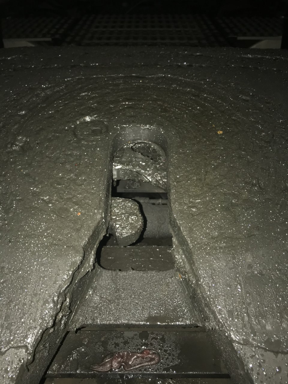

    I just went down to the truck and took this picture and this is after about 300 miles of traveling bobtail. As you can see the jars are about half closed.

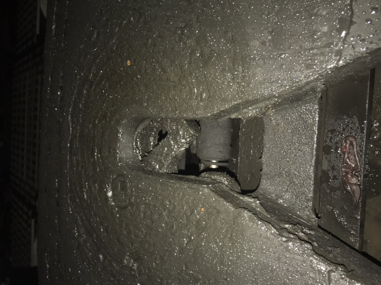

    I pulled the handle again and it opened up quite a bit more but I’m used to opening this thing once and it staying open. FC632C44-95A0-49C1-A211-303650F75B31.jpeg
