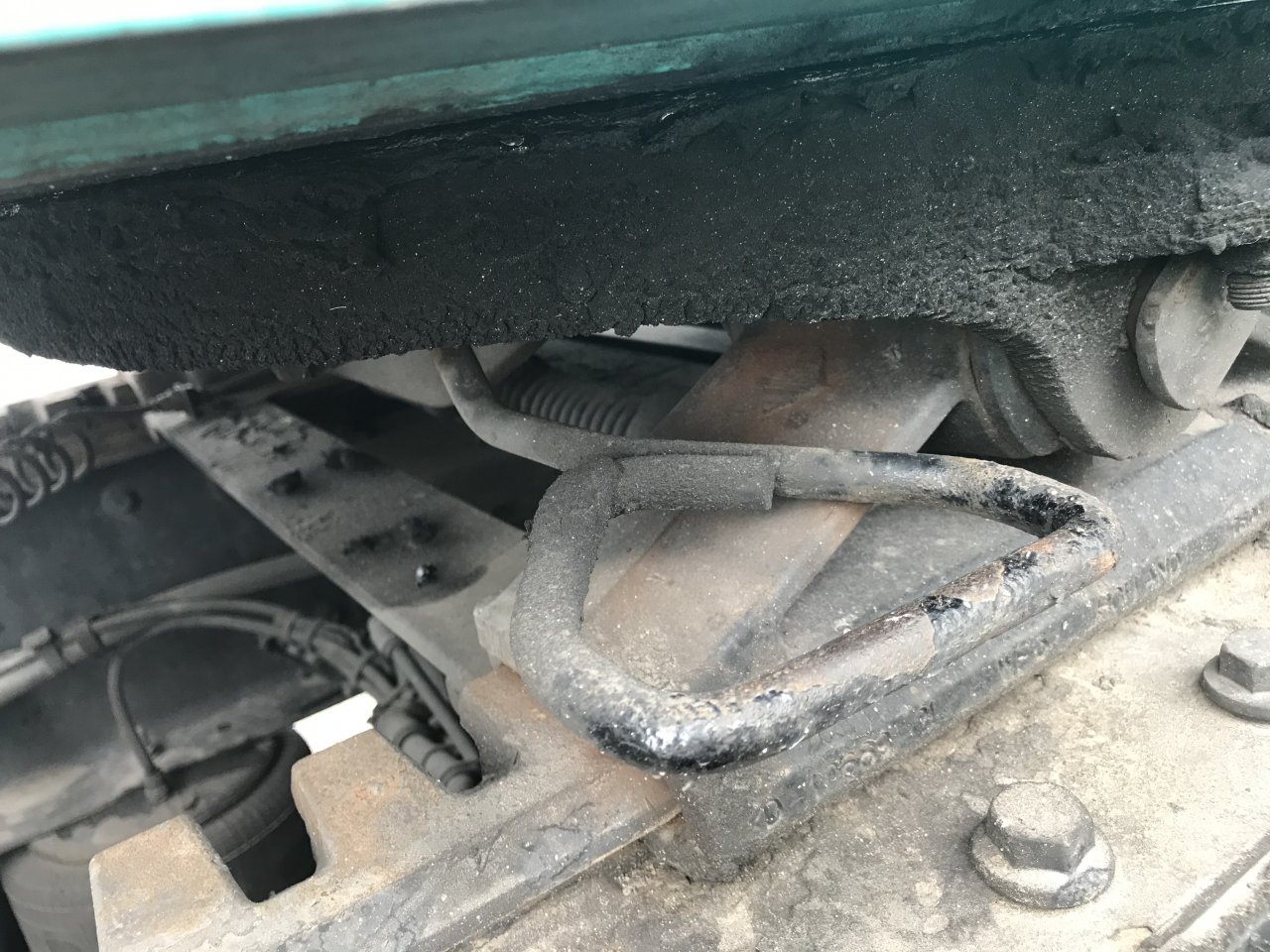

    The spring appears to be there and attached. A57DA9CC-DA89-40C9-AF59-124318DFB234.jpeg

    Looks like a Volvo.
    Could be out of adjustment???

    OK, that is not a jost. Looks like a Fontaine. It's been about 10 years or so. But last time I rebuilt a Fontaine it was $289 for the kit

    Possibly. I don’t see any adjustments. Is that something TA or speedco can do?
