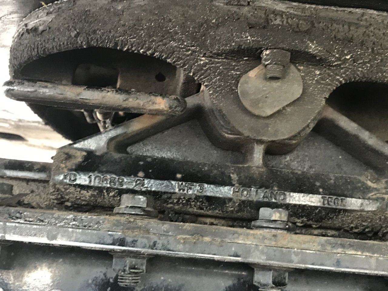

    Looks like the handle is riding on the saddle mount and the slider and there are some rust colored witness marks. It should not be making contact with anything like that. Is it just the angle of that picture?
    The data tag plate that has been mentioned on a holland is usually on the outside left hand side ear behind the the pivot pin.
    Google Holland Hitch Co. Or SAF/Holland for info.

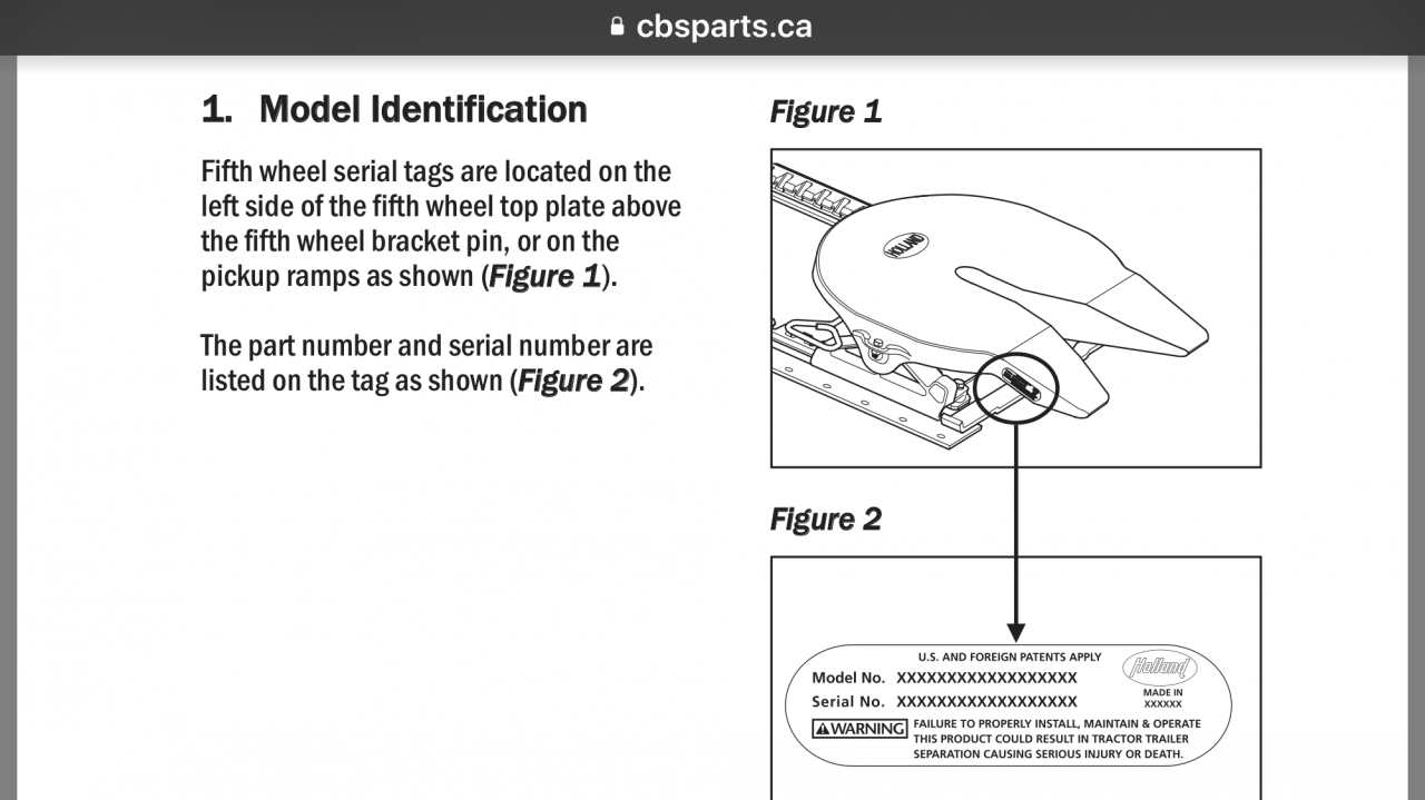

    The little plate that has all the info about your fith wheel.
    Modelnumber
    Serialnumber.
    Should be on the left side off the fith wheel plate itself,covered by old grease.
    In the picture you posted,that's the info about the support off the fith wheel.
