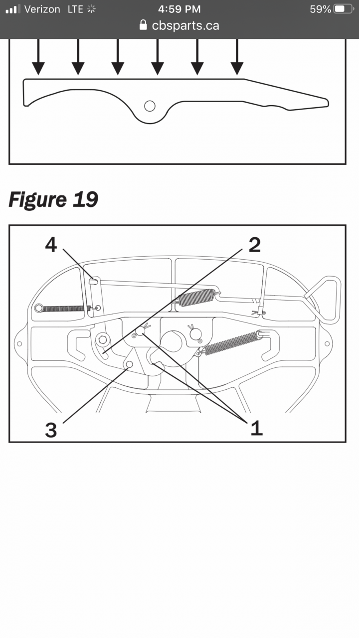

    Hee is what I googled holland 7f12 5th wheel manual
    Midnightrider909 Thanks this.

  5. Midnightrider909
    Midnightrider909 Road Train Member
    2,383
    9,599
    Oct 26, 2016
    Found it! First of all I am going to adjust it one click tighter. I don’t have the fancy kingpin simulation tool but I know it’s not as tight as it should be. I also need to clean it up and replace the spring farthest to the right on the diagram. Mine is stretched and not holding the jaw open.

  6. Midnightrider909
    2,383
    9,599
    Oct 26, 2016
    Thanks everyone. I think the mystery has been solved.

    Yes, thanks! I didn't know how to do it for the OP

    Glad you figured it out. Only thing is I am not sure if you can get the spring.
