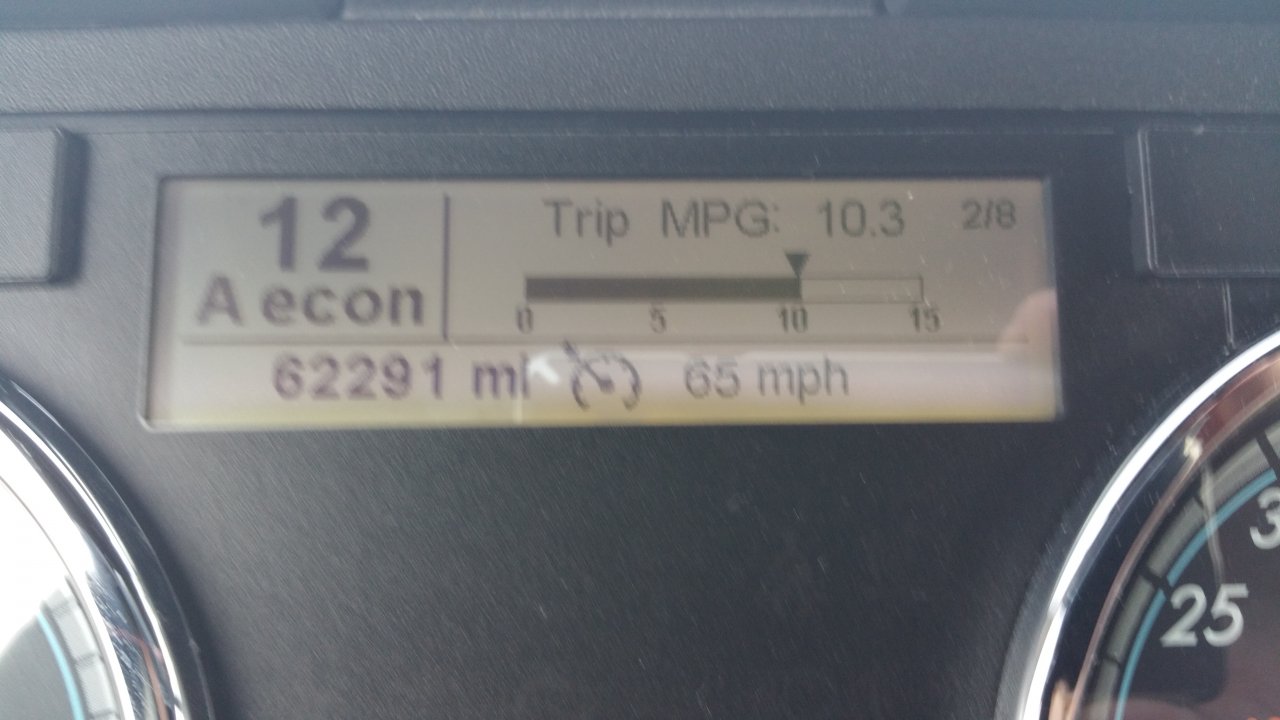

    image.jpeg I purchased brand new Cascadia 2015 with DD15,
    I have drove 154,000 on this truck, and satisfied so far on MPG.
    It's getting 7,5 - 8,0 per gallon with heavy loads 37,000+lbs
    And 9,5 - 10,5 per gallon on light loads 7,000lbs - 15,000lbs
    With driving speed 70-75 MPH
