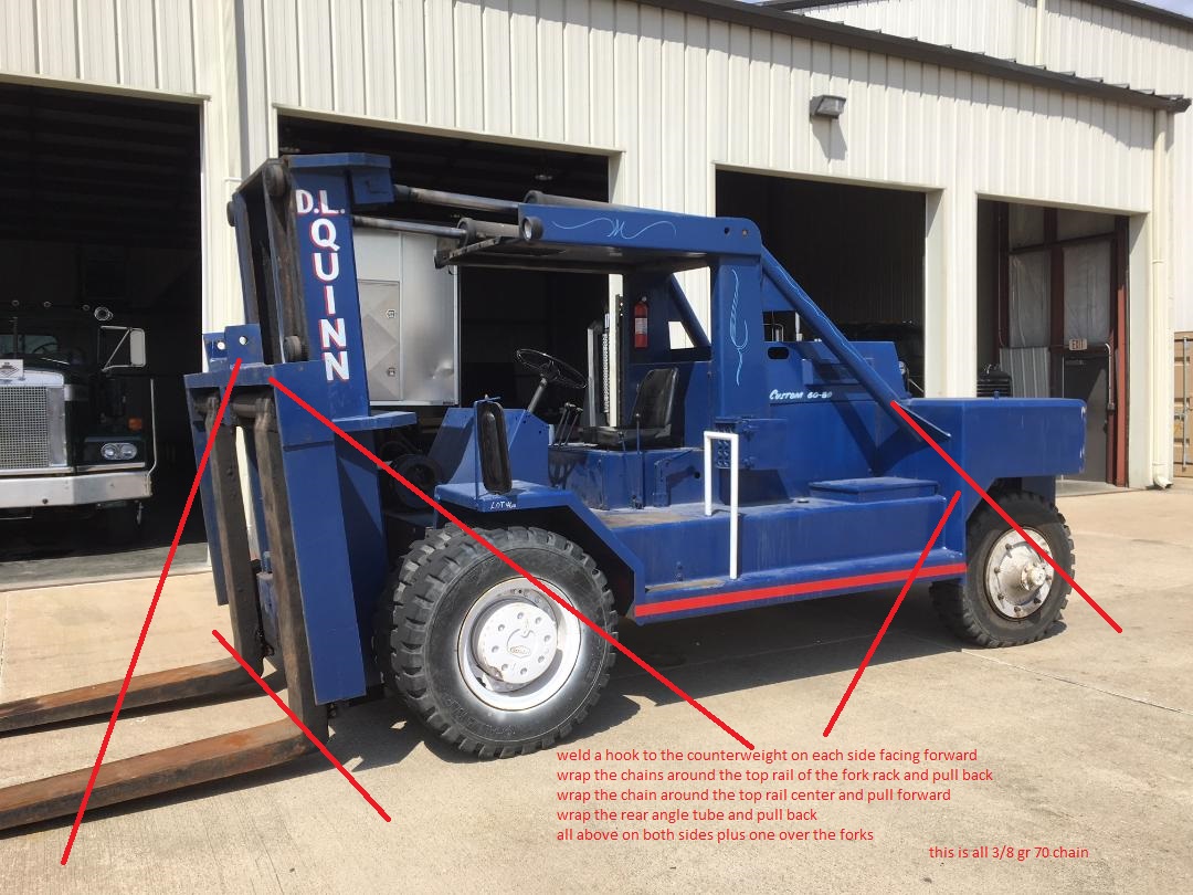

That’s still considered a direct tiedown so you get 50% credit for the chain. 3/8” grade 70 like that is good for 3300 pounds.
They do not make it divisible don’t worry about it. Just make sure they are secure.snowman_w900, Oxbow, ichudov and 1 other person Thank this. -
the tanks properly secured (caged/locked down) are part of the load, if easily movable they are NOT part of the load.
the picture below will give you enough tie-downs with 3/8 gr70 to cover a 66000# load. 8 at 3300# and one at 6600# totaling 33000# (50% of 66000)

Since you own it, Just weld D rings on it wherever they line up the best with the ones on your trailer.
Cross chain front and back. And at least one on the side higher up, so that you got room to work.
Make up some short 1/2" chains just the right length.
Then paint em titty pink so they don't wander off...snowman_w900, cke, Razororange and 5 others Thank this. -
This is probably the best answer you’ll get, just make your own securement points.snowman_w900, cke, ichudov and 1 other person Thank this.
Looks like a pretty good bit of ground clearance on that one though.
I’d say the fork cage would give 4 points to chain to, with at least 2 on the counterweight end. Then you have where that tube meets the counterweight like in @beastr123 ’s picture.
Easy peasy.
