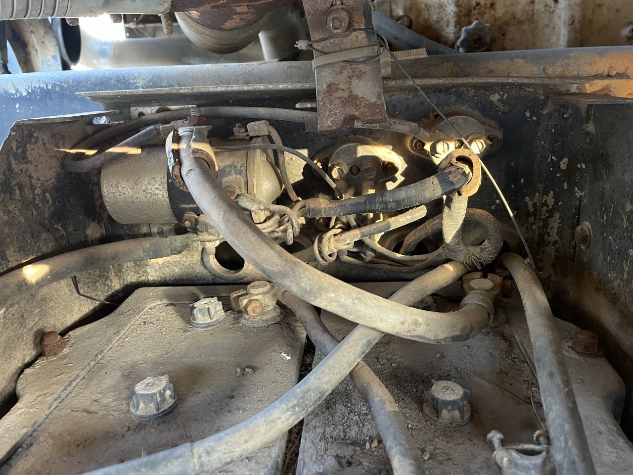

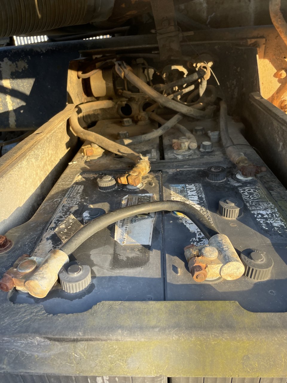

  5. OLDSKOOLERnWV
    19,614
    296,544
    Just to add to what @Oxbow is asking, your battery box look anything like this? This is my 83 K100C….
    B15EAFBB-CD21-446B-B9D9-740CCA0E4654.jpeg 6D61D226-5230-4DBB-8349-E92E2CB992FF.jpeg

    nt 855 small cam

    it is a 12/24v system and it does have a new Texas industrial 12v24v relay the starter is 24v but elec system is 12v

    yes series parallel switch
