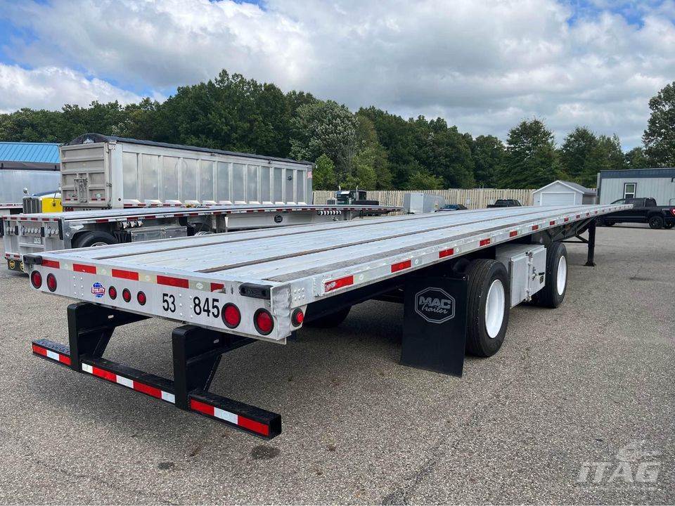

    Different rules for trailers over 48’ and those 48’ and under. A 53’ trailer with axles in the same spot as a 48’ (approximately 43.5’ KP to Center of rear axle) are illegal in many states. So are the 53’ trailers with a sliding rear axle, ours are 39’ closed to a 5’ spread and 44’ open to a ten foot spread. (When open) ca, fl, and to a lesser extent ct enforce this law.
    that’s why these goofy trailers exist either the fixed spread set so far forward. D862098E-F897-4FEE-8900-F930B1C385F6.jpeg
