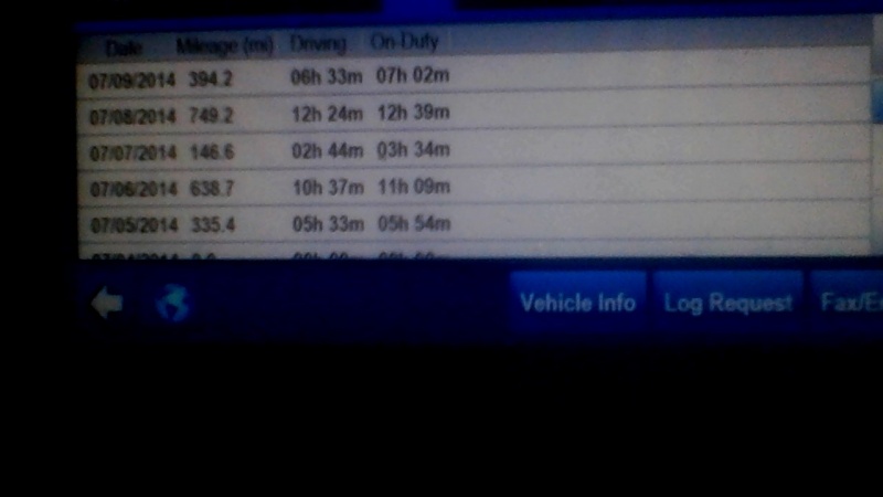

    picture058.jpg picture059.jpg Works for me. I do them so I don't have to take the darn tootin 30 min break, Had cruise set at 62. Get tired just pull over take your 8 hr or 2 hr break and keep on trucking. It also helps for those of us who can't sleep for long periods of time. Also helps like the on guy said to avoid the traffic jams. I took my break early so I wouldn't be stuck in the nashville traffic. Break should be up about the time people are getting home. Also you have to manage it good because like now I think I'll need 6 hours to finish my trip but my hours coming back might be 5 so I think to avoid having to stop again I'll take the full 10.
