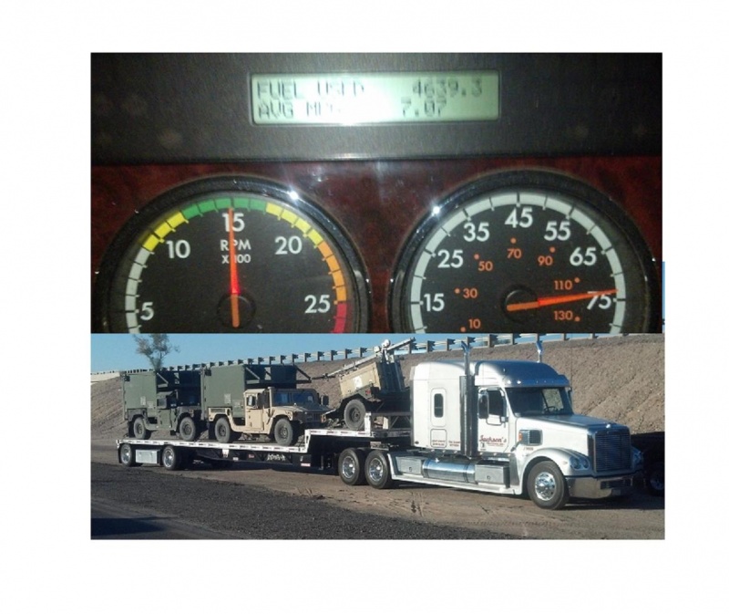

    Not useless , some can not get over that 6 mark. And there is better for them, as for me and you. But if you do not try it will never be reached. Control what you can then the rest is what the world throws at you. Have seen this truck pulling light in ideal conditions get mid 11. But every day in mid 7s . Heck wish my pick up would get 11 MPG. Working on getting that 7 up pulling grossed out up in the mountains. Less spend on fuel= more profits .

    Really...and as you see this was no 200 gallon used crap. 12.7 no egr/13 speed/3.42 tall rubber. LEGIT.

    Agreed they are good numbers, I am assuming that is a glider, BTW, at that MPG what was your average speed? I am going to guess here, but as pictured, I would say the truck weighs 18,000, the trailer is 12,000 and your "load" should be right around 24,000
    So with you, fuel etc, that pics grosses about 58,000? just curious how close am I?

    Most loads were at 30 to 40k . We run 72 to 75 as much as possible.
    Those were armor plated humvees.
    yes If we stay under 70k gross it will always hang above 7.
    yes it's a glider, which I think if we did slow down to 65 and had purchased 3.55 gears , or even went low pro tires I'm sure we could hit 8 all day.
    I really think the only way to really hit a realist 8 mpg is with a glider.

    Gliders are a great way to go! EGR hit every engine make hard! Then DPF hit them hard again. Most are trying to get back to where we used to be mileage wise! You and others like you made a choice, in going with a glider. And even with your set up (getting very good numbers) there will always be room for improvement . Our company is doing 40 gliders . But that's only 20% of our yearly order . Fritz does wonderful job but 200 units would take to long. And didn't want to use 5 or 6 companies to fill the order. Our first one is on the ground now.
