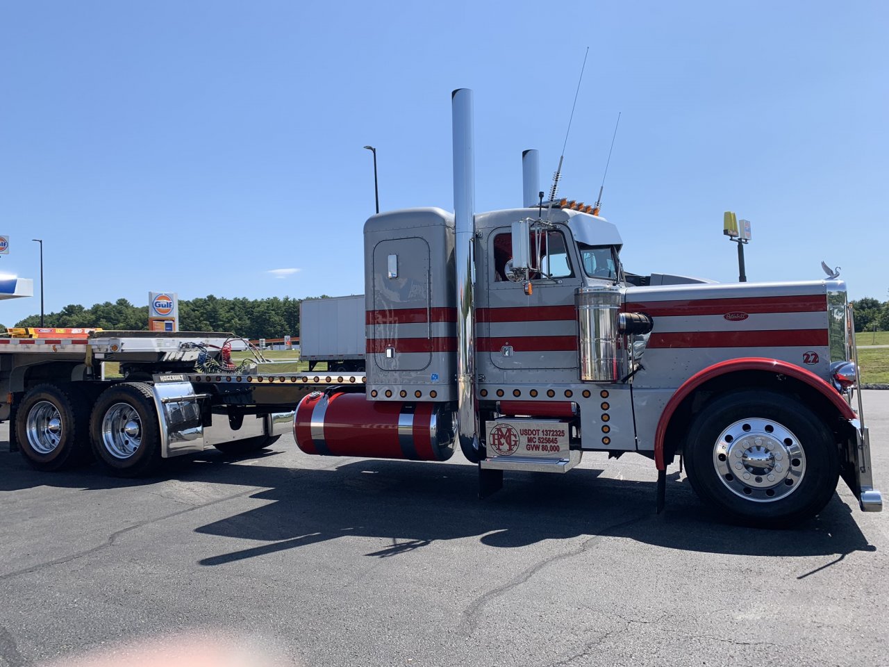

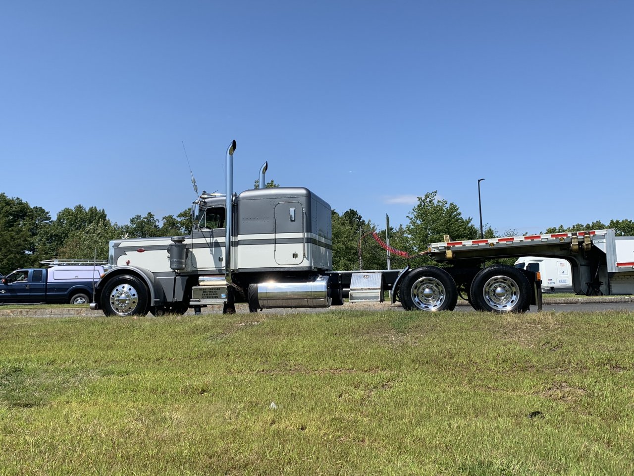

    It seems like your committed to refurbishing your 359. I hope you can see it through. I refurbished my 1985 359, it is a lot of work. I run the truck everyday along with my 1986 359. There is always something else to be done on any truck that works everyday. But I will say the older Pete’s and KW’s are worth putting the money into in my opinion. One piece of advice I do have is take your time to do each job right the first time. And don’t let others influence your work too much, because most of the guys that have negative opinions, have never been able to complete any kind of build like the one your attempting. Your welcome to PM me or get my phone number if you have any questions. I would prefer not to post too much on here bc I don’t need the sea of negativity from wanna be truckers.
  8. Largecar359
    Largecar359 Road Train Member
    1,075
    1,324
    Aug 13, 2011
    New Jersey
    50CA88AB-83E0-4162-8006-11944AC25B44.jpeg 87EAFBDC-D099-44A9-9FC5-FF1CD8617B38.jpeg CAE0B044-F91E-404F-B8E7-8540E8888B8C.jpeg Here is my fleet. 1985 359, 1986 359. Both with 7fb 3406B motors.

    I agree. Beautiful!

    Those are some outstanding looking 359s. You have a very nice fleet.
