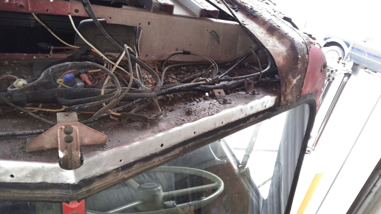

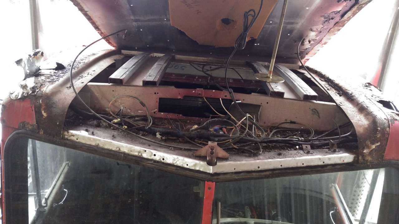

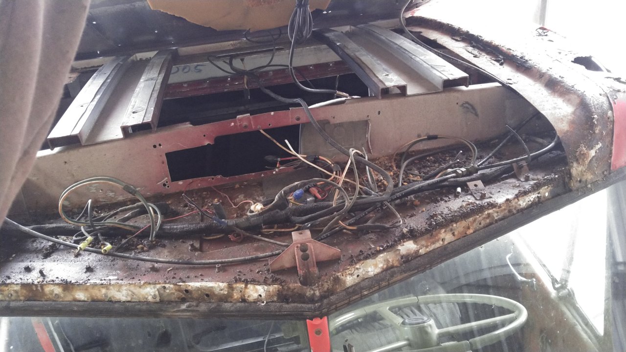

    Got all but a couple of the rivets removed on the roof. Left a few just to make sure the roof stays in place until I am ready to fit the new roof cap. I did pull the front of the middle section up to take a look under neith and make sure it wasn't overly corroded. Cleaned up pretty nice with a wire wheel. I think I will be fine there. Although I see I still have more mouse best to deal with. KIMG0510.JPG KIMG0509.JPG KIMG0508.JPG
  7. rank
    rank Road Train Member
    9,918
    113,505
    Feb 11, 2010
    Seal it up good. Mine leaks in heavy rain and I wreck a stereo every few years.
    FlaSwampRat, Tug Toy, wore out and 2 others Thank this.
  8. Ezrider_48501
    Ezrider_48501 Road Train Member
    3,845
    5,132
    Apr 2, 2011
    bismarck, nd
    replacement roof cap is a 1pc fiberglass so that should help as well. but right now whenever it rains the seat gets soaked and the entire floor is wet...lol ill be very glad when there is no longer holes you can reach your hand threw. im not sure exactly what ill be using for sealent yet but ill be dry fitting it first and then take it back off when my rivet gun gets here and sealing it and riviting it.
    looks like it was all sealed with something similar to the 3m adhesive tape before. not sure how many cheifs have been in that kitchen but there was patches ontop of patches ontop of patches on the roof. the drivers side panel was held in by all aluminum hucks and the passenger side was all steel hucks so someone has defiantly had the roof cap or at least part of it apart before. the place i buy my paint from has everything under the sun auto body related im going to see what they recommend for sealant.
